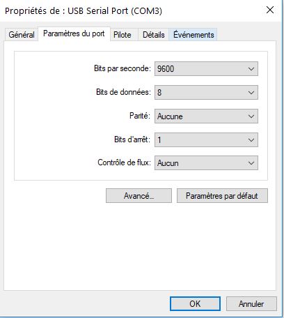

I tried every possible combination with SW2. What I understood is if I'm a using only one EVM with the GUI, I need to have my board configured in single ended mode.
What I already tried:

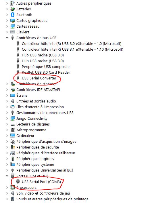

Here is my device manager setup, sorry it's in french:
Here is the configuration of the port (9600 baud rate):
Note that my USB Serial Converter has VCP enable.
Is there a way I can know if the PCB is the problem and not my computer or cable?
Do you have any tips that could help me figure out the problem?

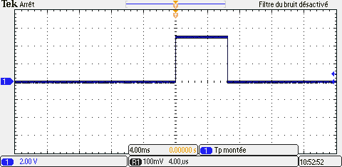

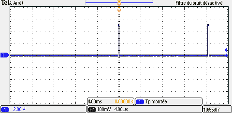

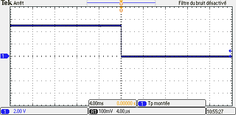

  • Hi Vince,
    I did what you told me and here are my result.
    I did a continuity test from the U1 pin49 and U2 pin4 and everything is fine.
    Here are my screen capture of the WAKEUP signal on the test pad. Sorry I wasn't able to get everything at one since the signal is long.
    I also probe the WAKEUP_N signal from the TTL-232-5V directly on the connector and it is giving me the exact same result as the WAKEUP going into U1 but reversed. The inverter is working properly.

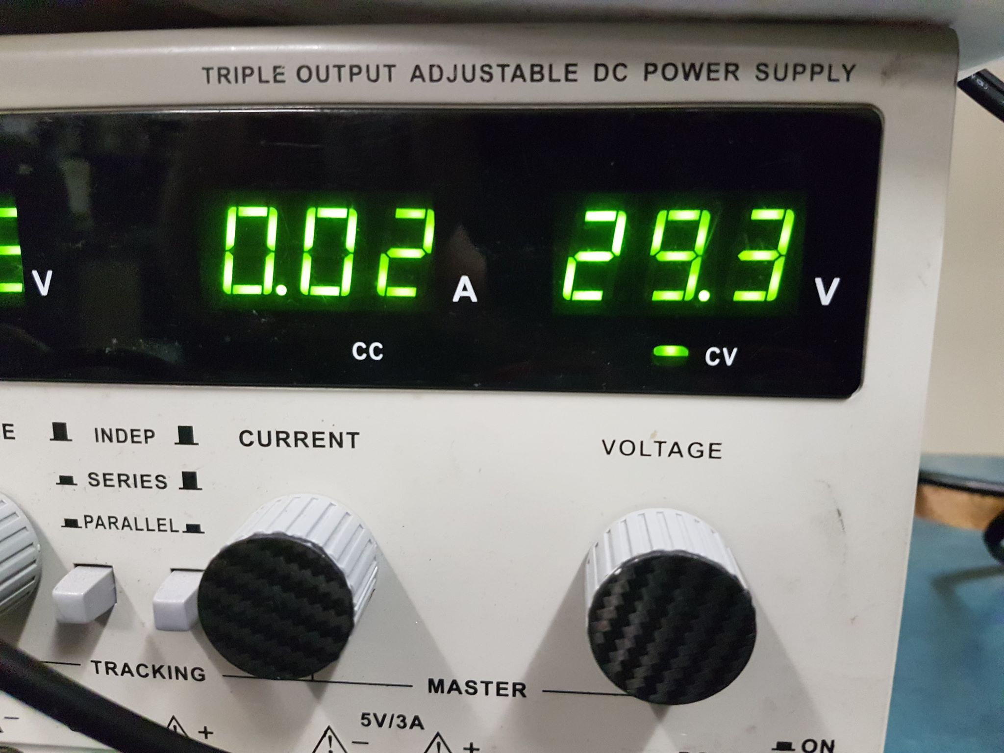

    Here is a picture of my setup. As you can see D22 is ON. The red banana plug output 29.2V.
    Here is a picture of my power supply before pluggin the COM port:
    Here is a picture of my power supply when the COM port is plugged:
    Hope this helps, feel free to send me any other idea you might have to make this work.

  • Hi Elio,
    The good news is the device is waking up (evidenced by the LED lighting up). We need to find where the communications are failing. Would you be able to probe the TX/RX lines of the 455 just like you did with the wakeup and see if any communications are being sent/received from the device? If the device is receiving comms but isn't responding, it could be a baudrate issue.
    Vince

  • Hi Elio,
    It is possible this is a cable issue, but before concluding that, I would like you to try changing the baudrate setting of your port to the PL455 default of 250k. Let me know if this affects the communications, or if you see any communications occur on the RX/TX lines in this case.
    Vince

    I can't select a 250k baudrate. The closet on my port is 230400.
    To change the baudrate I need to go in the properties of my COM port in device manager right?
    Is there a way to set a custom baudrate in device manager?
    Elio

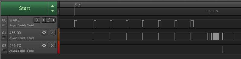

  • Hi Elio,
    The baudrate in Windows should be bypassed by the GUI on startup, so changing the port's baudrate in Windows may actually not be necessary. After testing on my own system, this baudrate actually stays at 9600 while the device is communicating at 250k, so this may just be the nominal value for Windows.
    For your setup, considering that the computer is unable to send any communications to the device's RX line, but is still able to send a wake pulse to the WAKE line means there is likely an issue with the cable itself. You should see communications similar to the image below with a functional setup:
    Would you be able to test with a different cable and provide the results?
    Thanks!
    Vince
