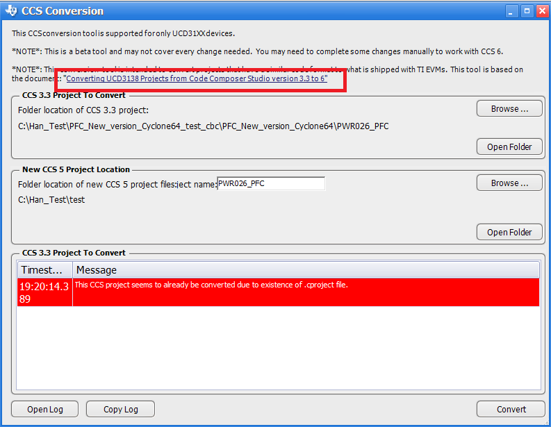

Good day, i'd like to know how to convert ucd3138 code from CCS3.3 to CCS6,does anyone have documents? thanks.

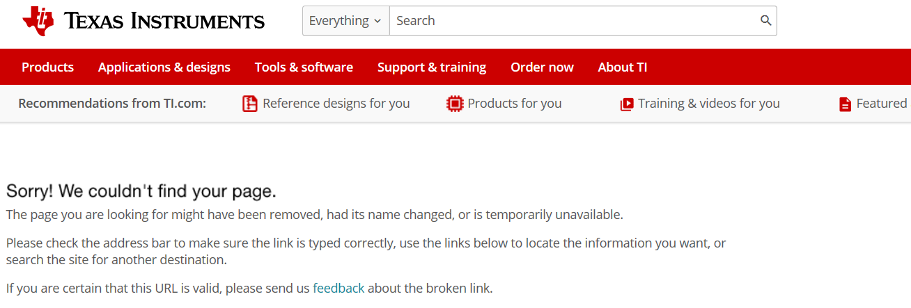

this guide has been integrated into the GUI above and has not been kept up to date which is why it is no longer available. It will not be referenced from the GUI in future builds. However I have attached that document for your reference here. Another way you can upgrade your projects is by starting with the new EVM code and copying and pasting your function implementations from your old firmware to the new firmware. Converting 3.3 to 5.2.pdf
