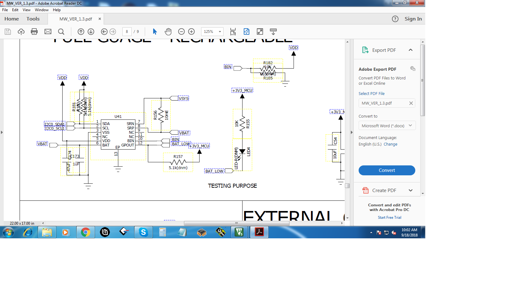

I am using Bq27441DRZT-G1A which is on i2c. I am using LI-ION Battery 3.7V 10.4Ah. So I have configured the maximum battery capacity as 8000mAh.
After configuring the guage I have sealed it and for every 20sec I am read the block value in which I am reading the battery voltage, current, battery_capacity,remaining battery_capacity and state of charge.
My questionis I have configred my battery capacity as 8000mAh but still it is showing 1200mAh.

  • Hi Onyx
    I am doing the configuration on every power on. And I am reading back the register. The guage is updating the battery voltage and temperature correctly,but not the battery capacity and the remaining battery capacity.
    After updating the parameters I am reading back the check sum after the software reset it is same as that of previous.
    I have provided the schematic if something I have missed please reply.
    Harish

  • Please read the CONTROL_STATUS register from the gauge. Is INITCOMP (bit 7) set?
    Please read the FLAGS register from the gauge. Is BAT_DET (bit 3) set?
    If these bits aren't set then the gauge didn't detect the battery and it will not report the actual remaining capacity. Did you configure the gauge to auto-detect the battery or is it configured so that it requires the BAT_INSERT command?
    There are a few other issues with your design:
    1. Just setting Design Capacity (and Design Energy by proxy) to 8000mAh for a 10000mAh cell won't work because the gauge will internally saturate some registers eventually if your cell has higher capacity (the gauge will update Qmax and if you cell is 10000mAh, Qmax will grow to reflect this number, which in turn will cause problems with various internal power calculations).
    You can scale this down (e.g. divide CC_GAIN by 10 and scale all current and capacity related parameters (and impedances) by the same factor. Design Capacity would then be 1000mAh).
    With a large battery, make sure that the max. current from your system doesn't saturate the current sense inputs.
    2. Unless you physically disconnect the gauge from the battery, do not reconfigure the gauge at every power-up of your system. This defeats the adaptive behavior of the gauging algorithm. Only configure the gauge if the ITPOR bit in FLAGS is set (which indicates that the gauge was reset and lost it's configuration/learned parameters).

    But I didn't understand point number 1, how to change the cc_gain and if I do that the 10000mAh is represented as 1000mAh???
    And I am able to read the discharging current but while charging it is still giving me discharge current value. But battery is getting charged I am measuring it but here remaining battery capacity is not increasing.
    And my batteries Chemical composition is Lithium Nickel Manganese Cobalt Oxide. And my chem id is 0x0128 which Lithium Cobalt Oxide. Is that a problem ???

  • About #1: The gauge determines capacity with discharge simulations using a model of the battery together with actual discharge measurements (coulomb counter (via sense resistor) and battery voltage). If you use a cell that exceeds the maximum capacity limits for the gauge, you can adjust the model (impedance tables, design capacity) and the coulomb counter measurements by a common scaling factor (e.g. by 10 or by 2 or whichever gets you within the limits). cc_gain is a floating point value which is normally set so that a 10mOhm sense resistor will result in a 1mA current reading from the gauge for a 1mA current through the sense resistor. You can scale this by 10 so that a 10mA current will result in a 1mA reading from the gauge. If you do that you can then use a 1000mAh design capacity setting for your 10000mAh battery (and you'd also have to scale the impedance table entries and any other current/capacity related parameter accordingly).
    If the gauge reports a discharge current when you charge the battery, then the charging current doesn't go through the sense resistor or something else is very wrong.
  • Hi Dominik
    Sorry for the late reply, after seeing your previous post I changed the current flow path which was initially designed wrong so now I can monitor the charging as well as discharging through fuel guage.
    But during configuring the fuel guage I connected supply also in the same time at that time the design capacity and remaining bat capacity were showing same which was highest but battery was not charged yet.
    If I remove the supply and just put battery back after configuring it was working fine and I connected supply back it was working fine.So while configuring the guage shouldnt I connect the supply ?? Or am I doing something wrong...
    Harish
  • if a power supply is used as a battery, then yes, you need to have it connected when configuring the gauge.
