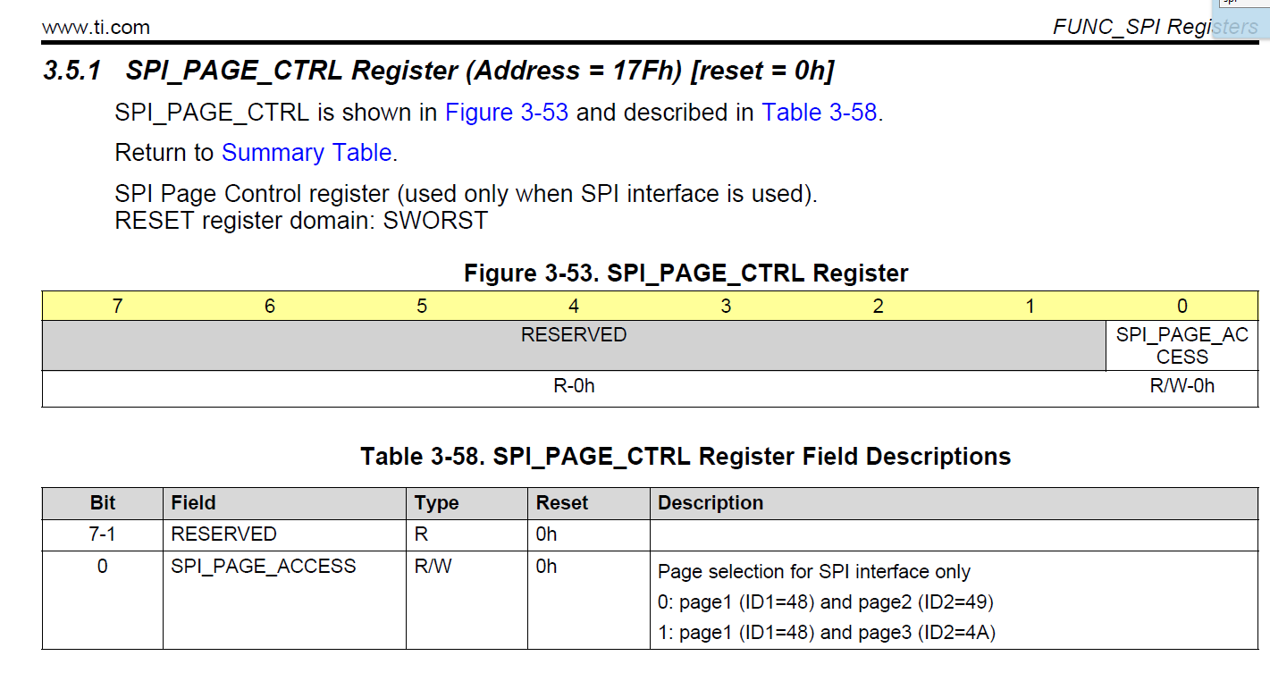

Hello everyone,
I need to access a TPS65917 over SPI. I've read the
with the register description.
In chapter 1.1 "register address mapping" 5 different pages to be addressed are mentioned. But in the SPI documentation of the TPS65917 I only see one page flag (and 8 address bits). I don't understand the register concept when accessing the TPS65917 over SPI. Any hint or tip would be very appreciated.
