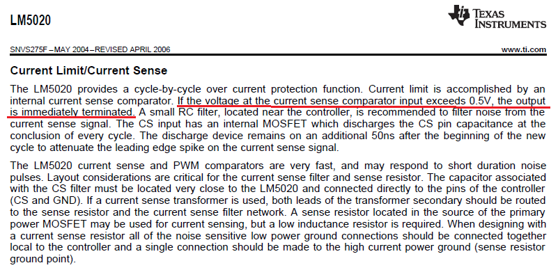

Hi, team,
Just need to check with you two questions as below.
1. When LM5020 is in current limit situation, will the chip go into hiccup or power limit? We found that the output voltage will drop in over current.
2. In short circuit condition, will the protection the same as current limit mode?
Thanks.
