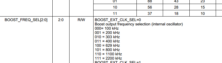

Hello TI Experts,
Now I am using LP8860A, and I meet with a problem needs your suggestion:
When the boost_freq_sel  is set to 001(303khz),input voltage below 10V, the screem  will flicker , over current protect~
When the  boost_freq_sel  is set to 101(800khz) everything is ok, their is no OVP or  flicker phenomenon~
I wonder why I cannot use the default value of boost_freq_sel 303KHz?
