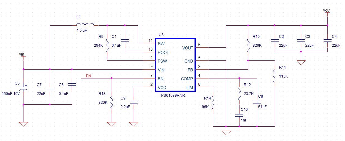

WEBENCH® Tools/TPS61089: Simulation error? Current increase causes Vout collapse
Part Number: TPS61089
I am using TPS61089RNRR for Vin = 3.1-5.5V Vout = 10V, 0.7A.  Testing of the actual circuit built according to the Webench shows that Vout collapses from 10V to ~4V if  the current load reaches 200mA. I suspect that the L1 value given the simulation is wrong; L1= 1.5uH. I would post a schematic if I knew how
