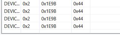

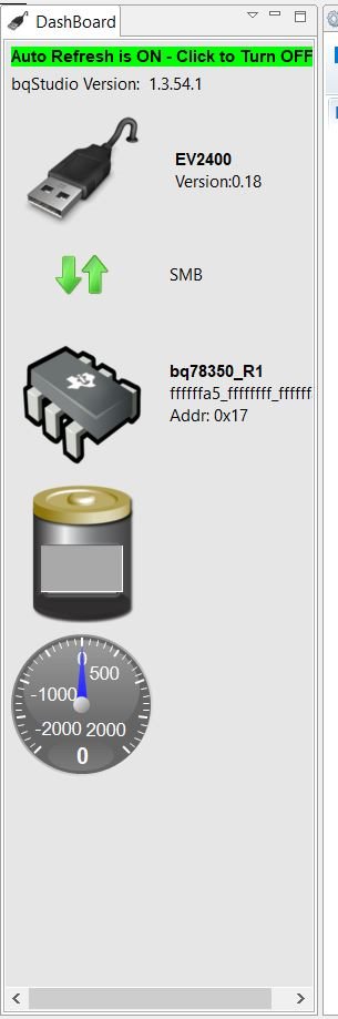

  • 1. This is a picture of the Dashboard
    2. This is the result when I run DEVICE_NUMBER.

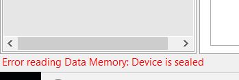

    3. This is the result when I hit Read All.  *Note: I did hit the UNSEAL command and entered 36720414 for the Key which has worked in the past.

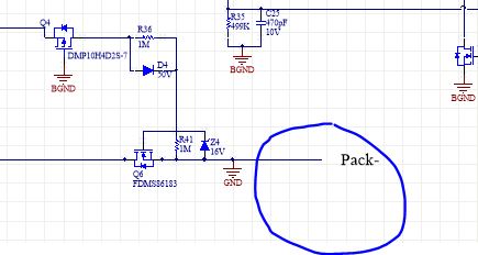

    6. This is the part of the system that is missing. Essentially there is no load. *Note: That is not the battery input into the system that is the output of the board.

  • Thanks Avak. This confirms that you are able to communicate with the device. The DEVICE_NUMBER command is giving the correct result. So the device is not in Shutdown.
    It looks like the device is sealed. Can you try reversing the code you entered?: 0414 3672
    Matt
  • It didn't seem to work. Also all of the bit registers are showing low or are grayed out I'm not sure why. I still can't get a stable connection between the bqStudio and the IC, it keeps disconnecting and because of that whenever I send a command it either doesn't get an ACK back, or it timesout. Occasionally it give me an error involving MAC. Could the problem be the EV2400?

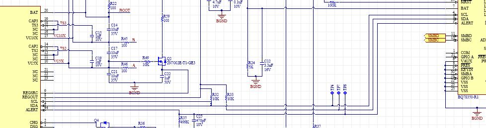

    Can you send the parts of the schematic for the I2C and SMBUS?
    Matt

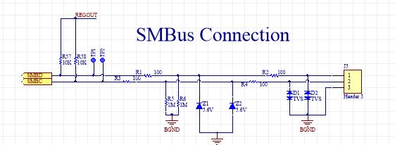

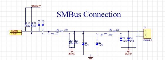

  • 1. This is the I2C connection
    2. This is the SMBUS connection. *Note: One the board itself only the series resistors and the pull up resistors are installed.
  • Are SCL and SDA connected together at the BQ76940 device? It is hard to tell from the schematic, but it looks this way.
  • They aren't that just happened while I was taking the snip, I double checked the board file and they aren't connected by a trace.
  • The IC may be in some sort of bootloop because it is constantly connecting and disconnecting, and for me to send a command like DEVICE_NUMBER I need to click it continuously until it eventually doesn't fail and goes through.
  • I may have found the issue. It seems I was u sing the BQ7694006DB with the BQ 78350-R1. This AFE supplies 3.3V instead of 2.5V and that might be what is causing me problems. I might have to wait until our next iteration of the board arrives to test this hypothesis. Does this sound like it could be the source of my problems?
