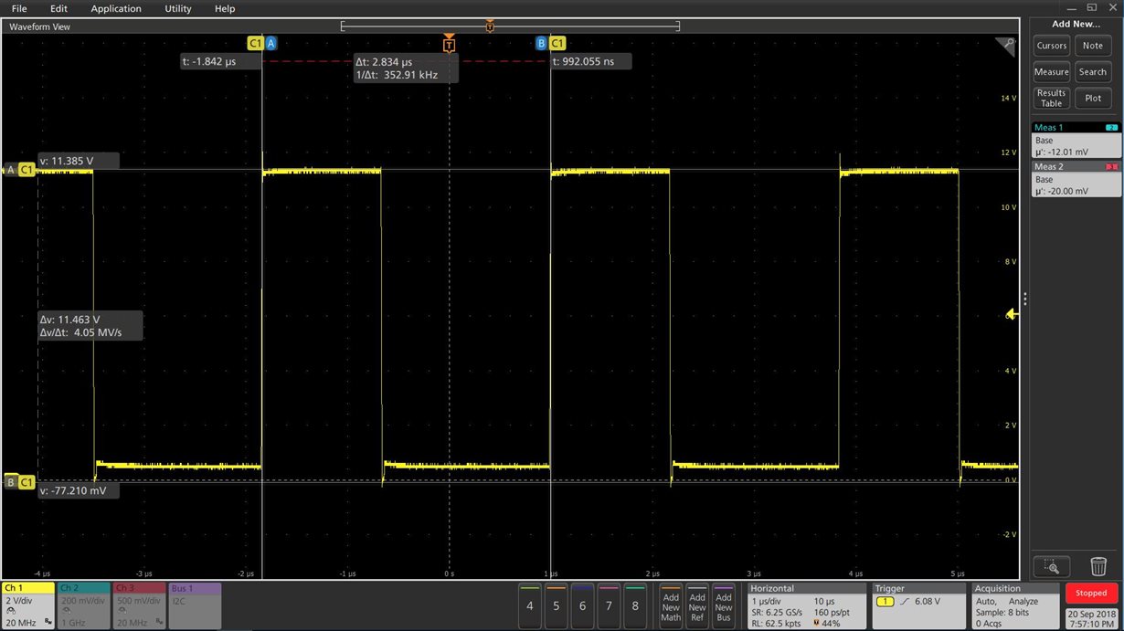

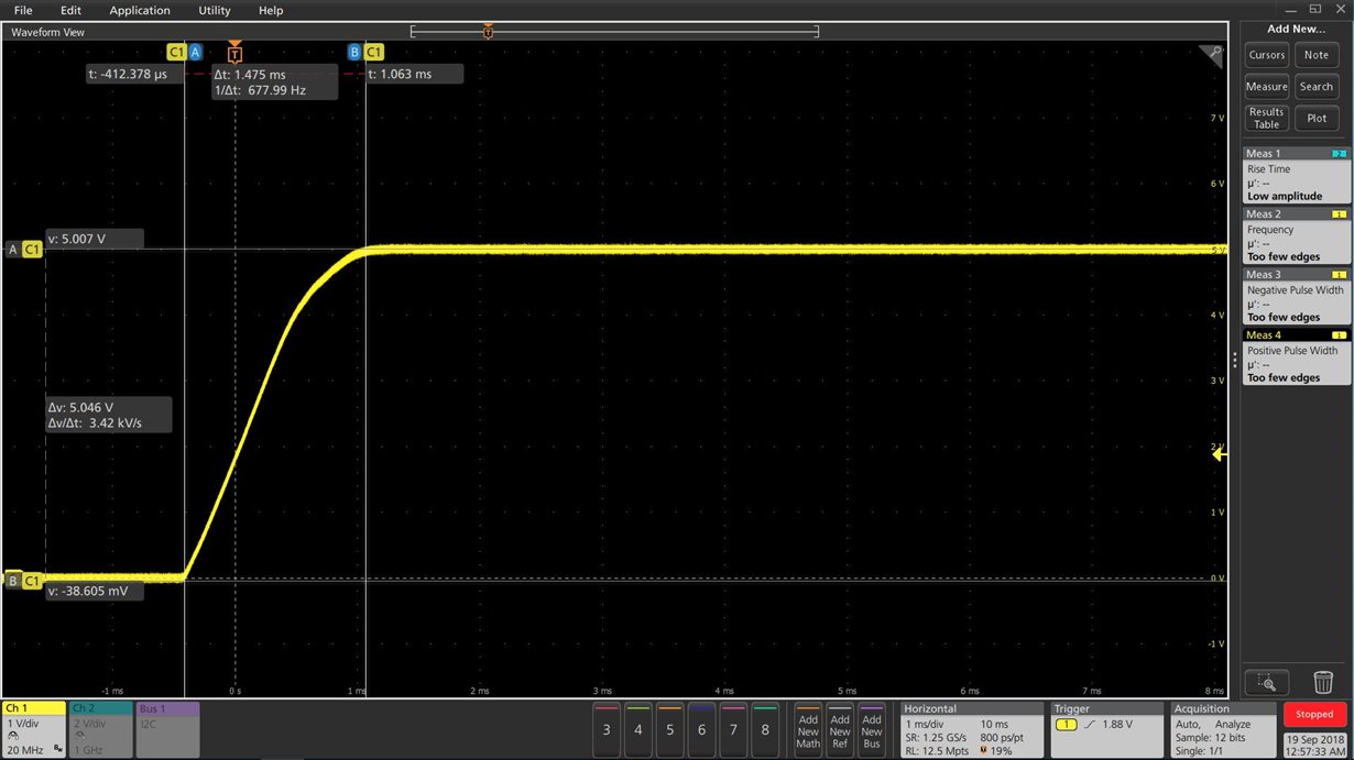

My customer has a system where:
12V -> efuse -> TPS568215 -> 5V.
The device is in FCCM, 400kHz Mode with a 0.047uF capacitor on the SS pin.
They noticed that when this capacitor is on there, there is overshoot when the device is starting up:
But when that SS capacitor is removed, this is what the output looks like:
Is there any correlation with regards to the SS capacitor and the peaking that occurred? The loads are TPS63036 and TPS62088, which are power sequenced after the TPS568215 is powered up correctly.
