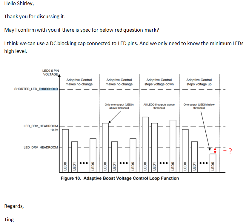

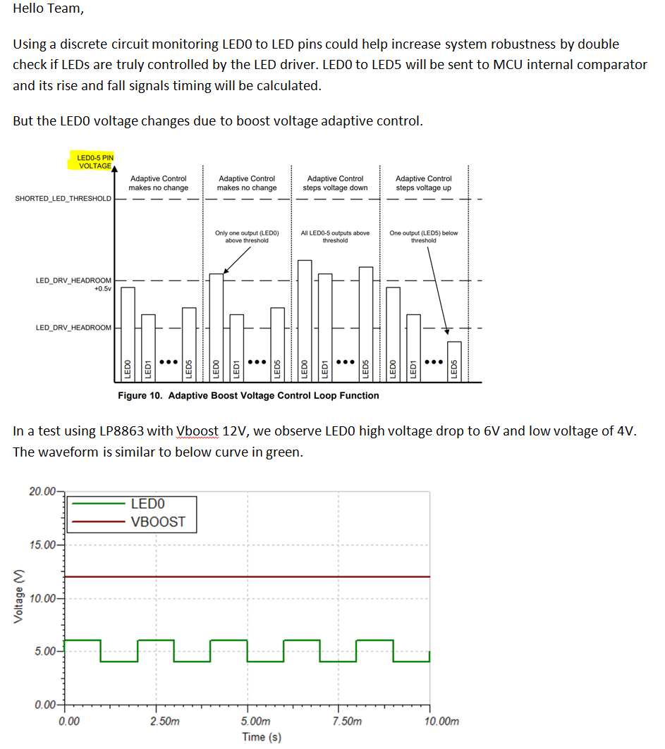

Since comparator circuit will be connected to LED0 to LED5 pins, a threshold needs to be decided.
May I know if there is equation containing Vboost, LED max forward voltage, and LED # etc., to calculate the LED0 pin high and low voltage level so that we can use the equation to set a comapartor threshold?
Thank you.
