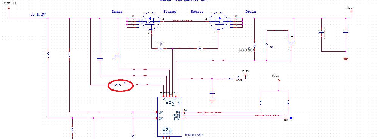

We use TPS2411 as oring circuit to OR BBU (7.2V) and main 12V rail and found there is still around 9.26V at BBU even the TPS2411 is disabled (12V is always presented), confirmed the Gate is 0V.
We used to use a jumper (0 ohm) to connect source bus (BBU) to A pin. After we removed the jumper, this leakage voltage is gone.

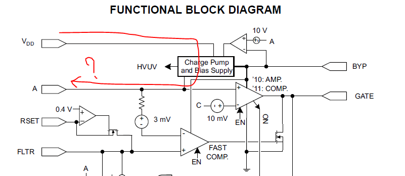

So we want to confirm is there any leakage path from Vdd pin to A pin by Charge Pump and Bias supply section?
Stan.

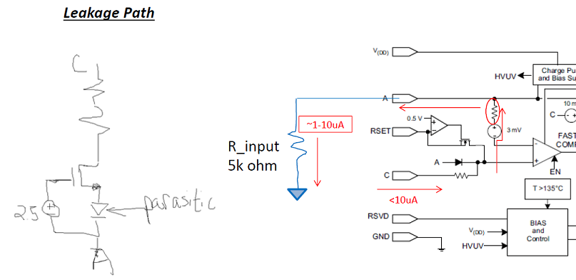

  • Hello Stan,
    There is leakage from C to A internal to IC. It is shown in the attached PDF document.
    Solution is connect a load on A based on the attached data.
    With 5K at A, I measure 4.6V, --> this means 0.92mA current.
    With 150k at A, I measure 10.0V --> this means 0.066mA current.
    This is consistent with attached measurement from the E2E thread.
    1738.1031.TPS241x Leakage Path_Measurements.pdf
    Let me know if this answers your question.
    Kari.
  • Hi Kari,
    Thanks for you reply. The leakage paths are different between two documents. Could you please confirm which one is correct?
    Do you have any ideas regarding the current rating of the parasitic diode and the voltage source?

  • Hi Stan,
    0.68mA of current would not be a problem.
    However, 25 ohm of learning discharge resistance would cause the inrush current through the external MOSFET (MOSFET is initially ON when BBU was turned ON). When BBU is turned off (with discharge resistance of 25ohm), reverse current would flow from C to A through the external MOSFET intially. If this current exceeds the reverse current threshold set, then the MOSFET will be turned OFF.
    Do you see such a scenario?
    We want to confirm if all the inrush current measured flowing through the MOSFET external or the internal to the IC?
    Kari.
  • Hi Kari,
    We do the learning discharge only when the oring controller is disabled. The external MOSFET is B2B connection.
    So we didn't see the scenario that you mentioned. The 0.68mA inrush current that leaked from C(main 12V) to A (BBU) by controller internal path during system power on. I calculated this current by the Vdrop on the resistor(1K) of protection circuit on pin C.
    It's the worst case that even larger than the inrush during learning discharge enabled.
    BR.
    Stan.
