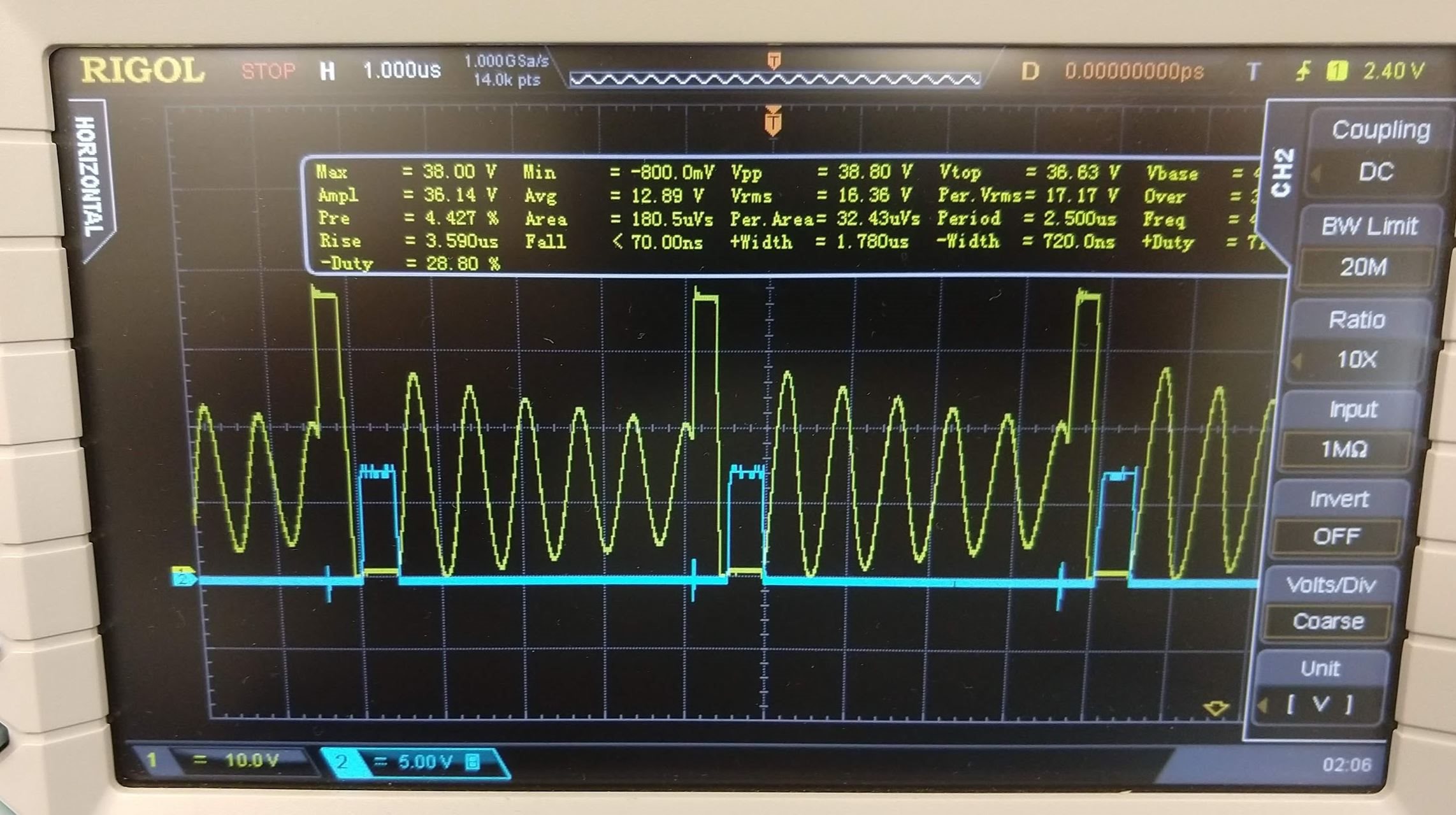

LM5116: LM5116MH Funny waveform
Part Number: LM5116
I am trying to make a buck converter using the LM5116 and I am getting ringing.  The waveform below has yellow as high side gate, and blue as low side gate.  It appears the low side gate is turning off and causing ringing on the SW node.  Why is the low side gate turning off? I would expect that it would remain on for the entire cycle until high turns back on?
