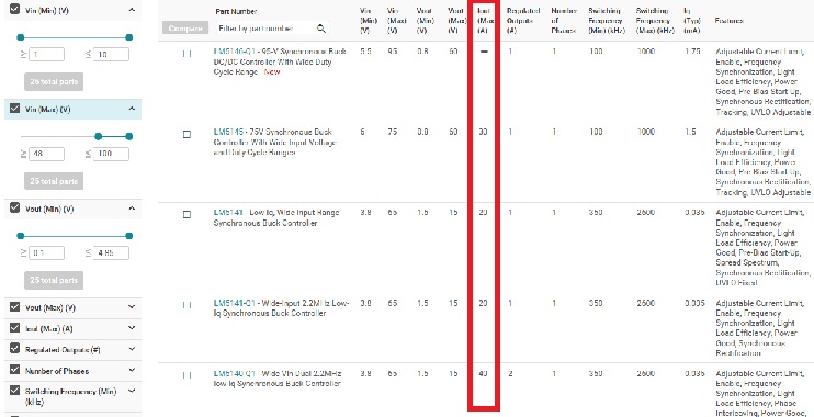

From TI.com, can see the Iout(max) of LM25119 is 40A.
As I know, the current limitation is all about MOSFET and Inductor, am I right?
Here are the question:
1. How this 40A be defined?
2. What limits the output current?
3. Can I use it support 40A+40A?
Thank you.

  • Hi Qian,
    Got it ,thank you very much.
    May I ask another question? So how the Iout(max.) be defined in TI.com?
  • Hi Chentsu,
    LM514x is a controller. As you know, the current limitation is mainly from MOSFET and inductor.
    maximum current we suggested is for typical applicaiton. It does not mean the controller can not be used for higher current.
    Sorry, I'm not very familiar with LM514x parts.
    If you have further questoin on LM514x, I would suggst to submit a new post. Someone else will support it.
