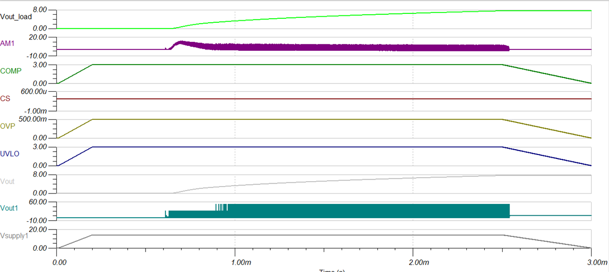

  • Hi Peter,
    I had tried running the simulation with your suggested parameter tweaks. The simulation result shown that the controller only operational when Vin is >= 14V which is contradict with the datasheet. I had forced the UVLO, OVP, COMP to a standard DC voltage and grounded CS which shouldn't result in the shutdown of the controller. That was pretty much the scenario I have seen with the physical chip.
    Any advice to make it operational in 12V for VCC & VIN will be appreciated.
    Modified file as attached in 12V for Vin.
    /cfs-file/__key/communityserver-discussions-components-files/196/LM5046.TSC
    Picture as shown below is when Vin is in 14V where at least the mosfets are switching.
    Picture as shown below is when Vin is in 12V where the mosfets are  not switching at all.
    Thanks.
    Rgds,
    weichun

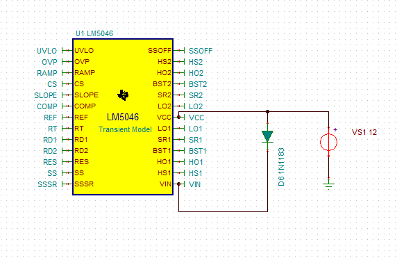

  • Hi Weichun,
    From reading the datasheet it says that the device should run from Vcc, but Vcc must be supllied from a regulated 12V rail. In that case I suggest you leave Vin open circuit and connect a diode from Vcc to Vin to bypass the parasitic diode of the Vcc regulator.
    I agree the sim does not run if Vin is below 14V, but that may just be an issue with the model which I need to check.
    If the min input voltage in the application is down to 12V then I think you will need a separate bias supply to provide the 12V for the Vcc pin, maybe something like a low cost flyback could provide a regulates 12V to Vcc for the application input voltage range.
    Peter
  • Hi Peter,
    Thanks for your suggestions. I will give it a try then.
    Rgds,
    weichun
  • Hi Peter,
    I assumed that your suggestion is as shown below.
    The exactly setup was configured as shown as above. Upon power up, okay it didn't trip my 12V external power supply this time. However, once I source the COMP pin to 3V for switching it went haywire again. It not only didn't switch but drawing a few 100mA from the supplies causing the IC to heat up around 60degC.
    Same setup procedures without diode & 12V but with 14V through Vin, this time all things worked as expected as per our simulation model.
    I think that it might not be the model went wrong but the datasheet!
    Appreciate if you can have your hardware team to verify on this. If it really cannot support a 12V VCC input as claimed in the datasheet, then I'm going to scrap this and move on with other solutions.
    Thanks.
    rgds,
    weichun
