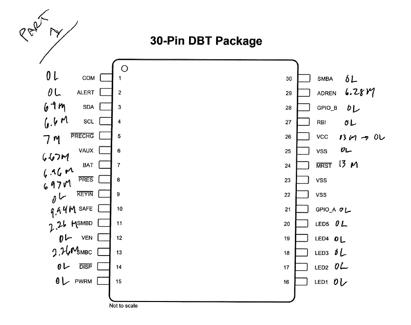

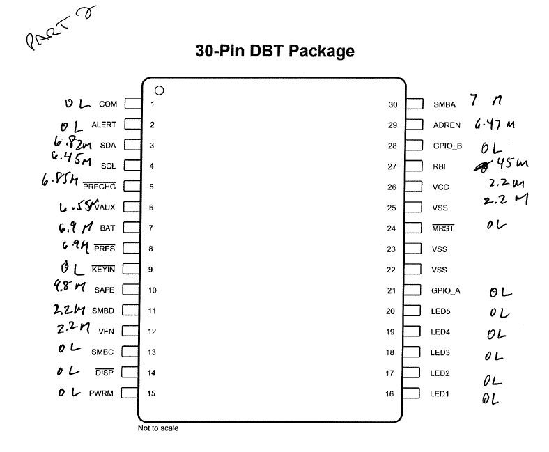

  • Matt
    On 9/20 you asked me if I can tell if any of the pins themselves are shorted.  I have removed 2 parts, and measured all pins referencing pins 23&24 (purposely shorted these VSS pins together).  See images below, but I'm not seeing any short circuits externally like this.  On one of them, VCC was jumping around between ~13M and OL, could be just a bad connection because on the other one it was about 2M.
    I'll review the link you sent me today.  Any more luck on your end?
    Thanks, Mike

  • Hi Mike,
    The link to the older thread is what we think is most likely the issue. I looked at your resistance measurements, and I'm not sure what to think. It doesn't appear you observed any low impedance paths. Is it possible that by removing the BQ78350 from the board, you are breaking a low impedance path related to the damaged 3.3V regulator?
    Matt
  • Matt,
    I believe we figured out what our problem was.  Our 3.3V regulator that was referenced to the switched ground is a switching power supply.  If you remove its ground, there is no way of knowing what it is going to try to regulate to, I'd assume whatever the ground floats to it'll try to regulate from that.  In investigating my 3.3V short after removing the BQ78350, I found various devices powered from that part to be shorted out.  How that damaged the BQ78350, I can only assume that it pulled up those SMBus lines to a voltage greater than what the part can handle.  Does that make sense?
