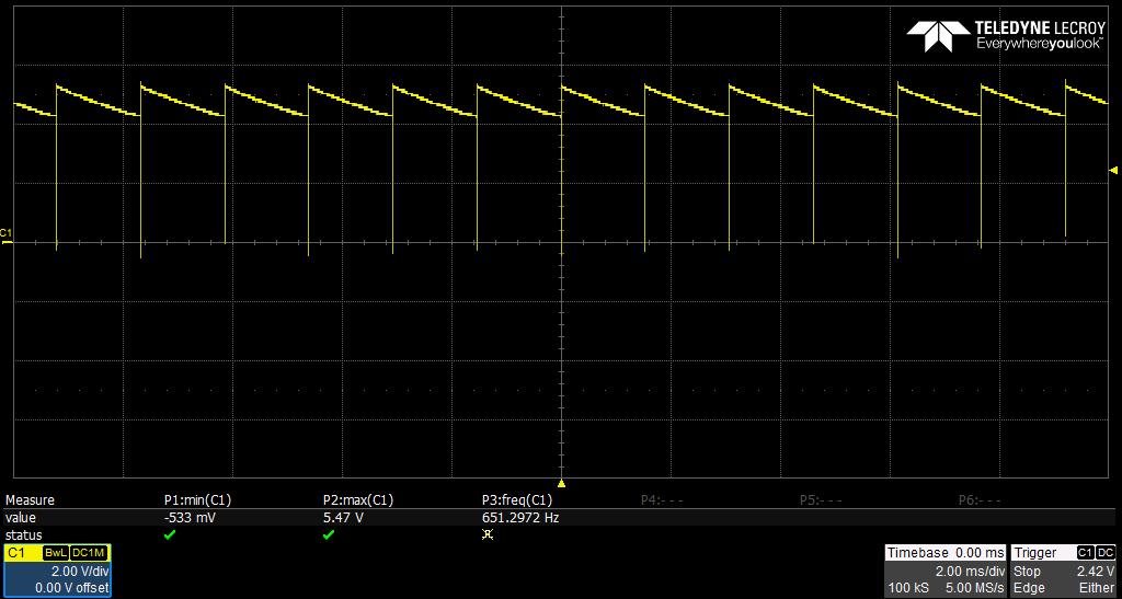

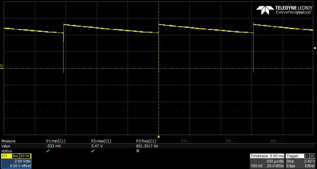

I use an aux power 30v supply bq24640's VCC to avoid sleep mode, and output voltage design for 28.5v.
When Vin < 28.5, the idea Buck's output should be equal Vin, and the PWM should keep switch frequency with maximum duty.
But When Vin small then 28.5V, the switching frequency down to 0.65KHz (typ is 650KHz)
How do I avoid this situation?
    The behavior is the nature of buck converter when running into maximum duty ratio limitation. The charger is basically a step-down DC-DC (buck) converter. It requires the input voltage to be higher than the output voltage with some headroom for normal operations. Please refer to the paper below for the details. Users should avoid maximum duty ratio operations in their designs.
