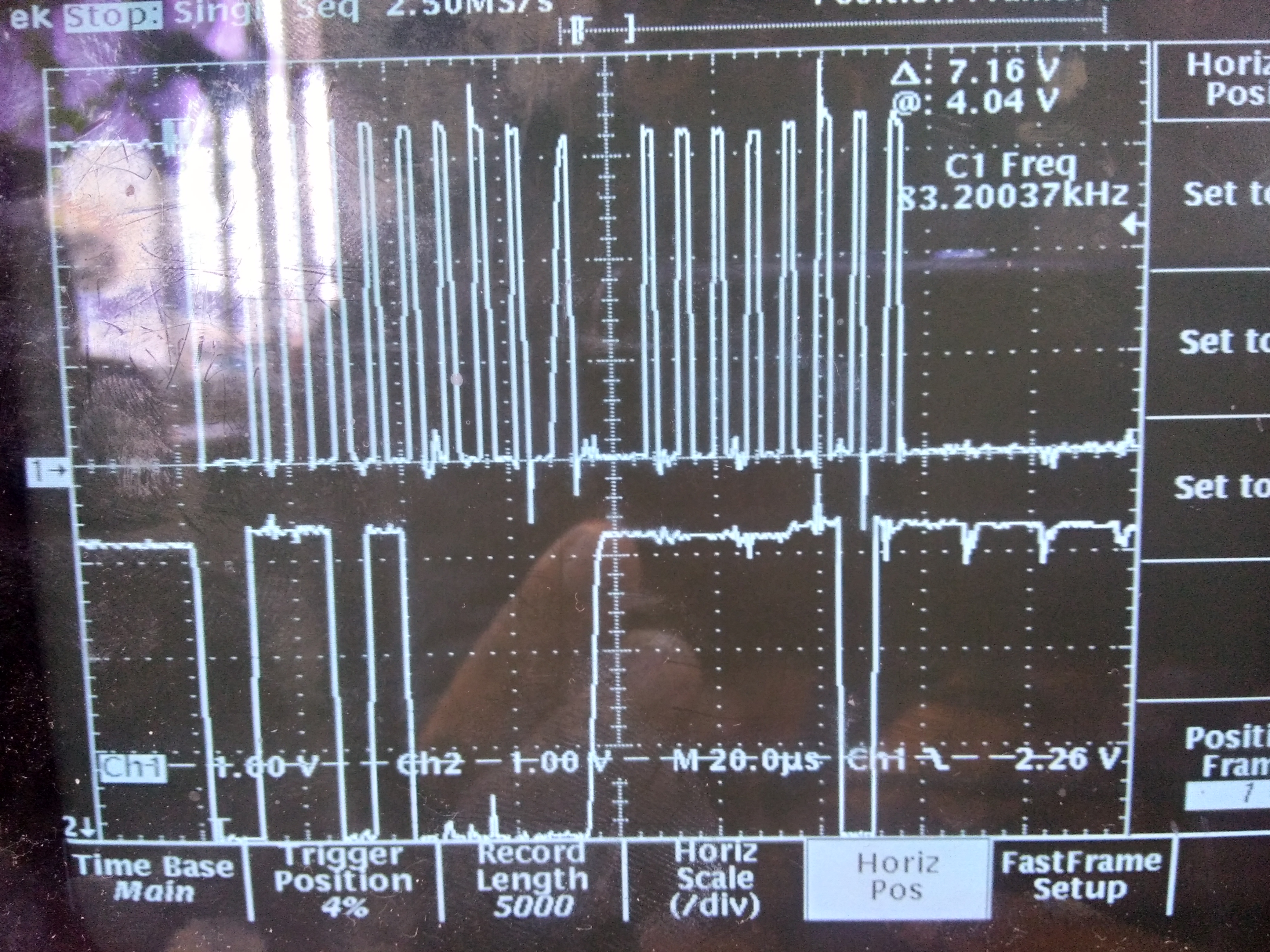

  • Could you capturet the waveform with scope instead of logic analyzer? this will help.
    as i2c host is required to read back the clock signal after releasing it to the high state and wait until the line has actually gone high. once it goes high, the host shall continue the clock pulse. i can not believe that i2c is low at 100ms.
    Please refer the waveform capture from EVM with 400KHz clock. you can see the clock streching after 0xFD is received.

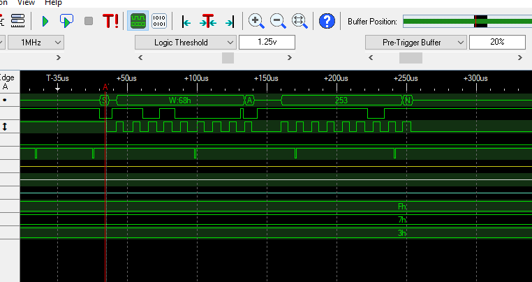

    I waste all day yesterday. My waveform is attached. Still cannot get second ACK. The device release clock after huge (about 100 ms and more) time and with NACK. Seems i have waveform like you have sent to me, but....I can guess problem with rising power. May be i must use a curtain frequency. Or time intervals between power-rising and i2c-start? Or some other restrictions?
    I'm so sorry to disturb you but may be this waveform will give you any information whats wrong
    I noticed that waveform is heavily dependent on delay after power is on
    Dmitry
  • you are running at 100KHz. what's your pull-up resistor?
    100ms is defnitley wrong since this violates PMBus spec. the bus shall not be hold low more than 35ms.
    What did you mean the waveform is heavly dependent on delay after power-on? how soon did you start send the command after the 3.3V is stable?
    Is the UCD9090 working relaible in your setup? Do you have other i2c master tool to try? maybe try to order www.ti.com/.../usb-to-gpio, this is a approved solution to support UCD9090.
