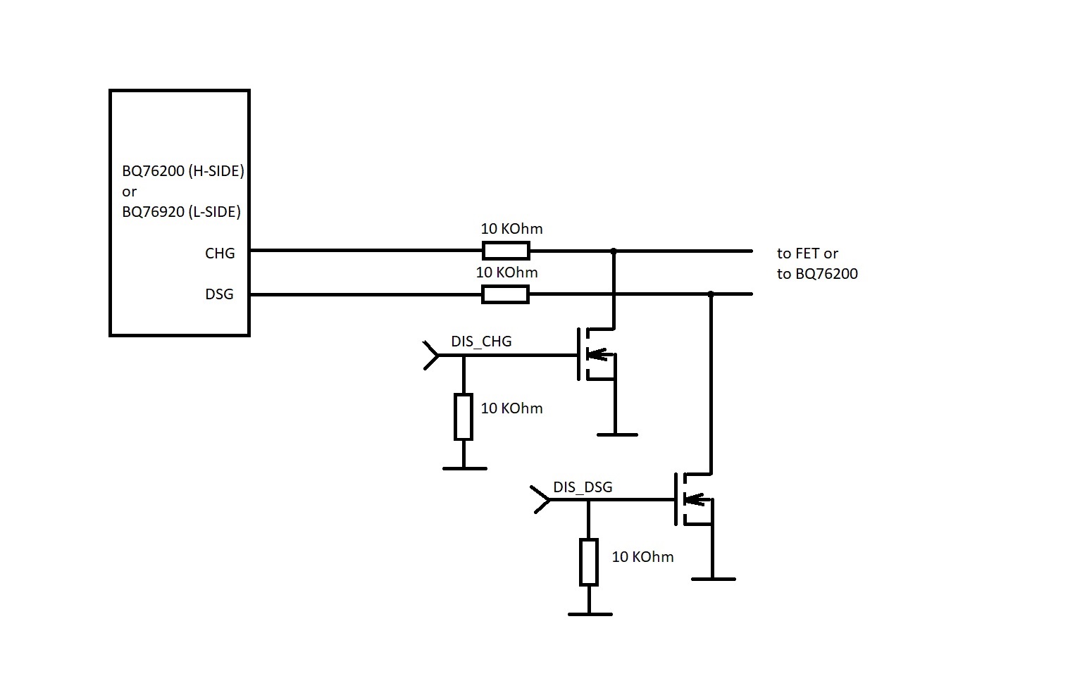

Dear Texas, I prefer to make additional (2-nd level) protection for BQ76920 and BQ76200 and want to quickly OFF  driver output of both devices by grounding signals through additional mosfets.
My question, what is recommend max. load current of fet driver for BQ76920 and BQ76200? Is it possible to grounding through 10 kOhm resistors?
