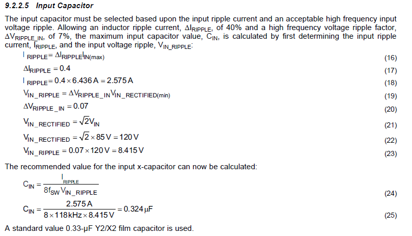

Hi Team,
1)
The following calcuration of input capacitor shows "recommended value" and I believe it isn't refered to "mimimum value".
Is there maximum value of input capacitor for operating normal operation of PFC?
2)
The calcuration above include VIN_RECTIFIED(min).
Why does it adopt VIN_RECTIFIED(min) not VIN_RECTIFIED(max)?
Yaita / Japan disty
  • Hi K.Yaita,
    The capacitor calculated is the value required to meet the specified target of 7% at peak of low line.
    The highest ripple current occurs at peak of low line, hence the ripple voltage calculation is done for this condition.
    Joe Leisten
  • Hi Joe-san,
    Thank you for your kind support.
    (Is there any concern if input capacitor is significantly larger than calculated value?)
    Yaita
  • Hi Yaita-san,
    No problem if a larger capacitor is used.
    Increasing the input capacitor will slightly degrade pf and THD. This is a small effect and even if you double or triple the calculated value the effect will be small.
    Joe Leisten
