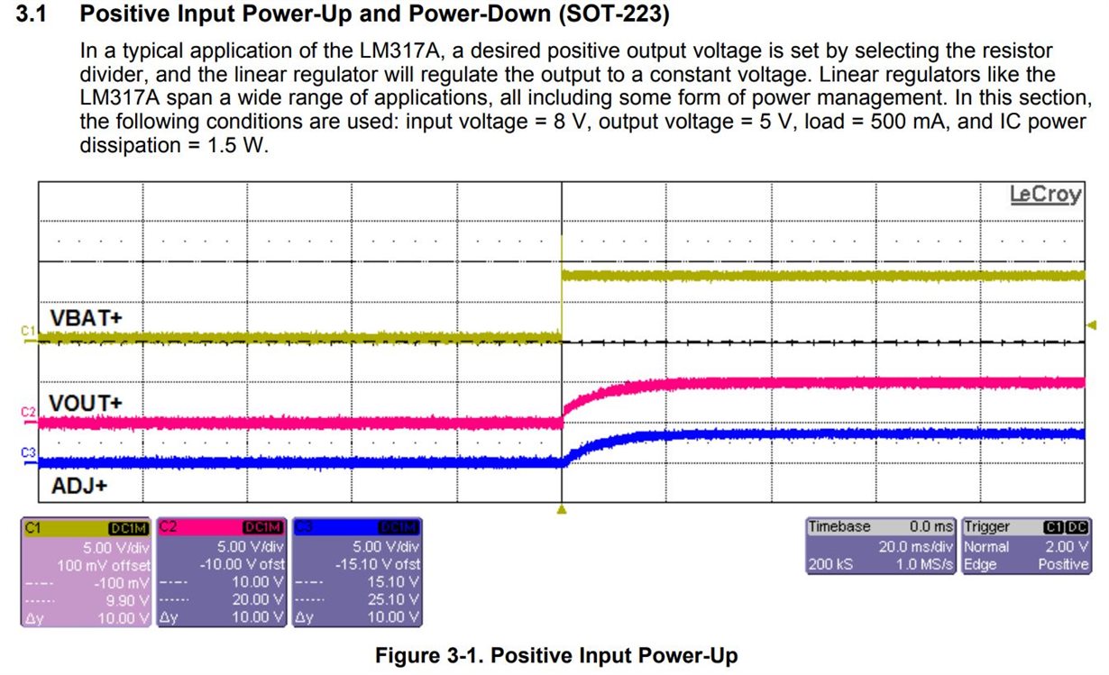

    Please find the startup for the LM317A bellow taken from the EVM User's Guide.  While this is for a 5 V output, the startup time will be similar for the 3.3 V output due to the fact that the output is a gained version of the internal reference.  It is the internal reference ramp that defines the output ramp.
    If you choose to use a feedforward capacitor or have enough output capacitance to trigger current limit, your output ramp will be slower.

    In EVM User's guide p.6 Figure 3-1 ,
    It seems soft-start time is about 1mS.

  • Hi Takahiro,
    Please note that the timescale is 20 ms/div. As such The startup time from Vin rising to Vout reaching its final value is 20 ms.
    We do not have any test data on the startup time for this linear regulator. The startup time was not a key specification at the time of release of this linear regulator.

  • Thank you for your answer!
    User's guide p.6 Figure 3-1,
    Current is 500mA.
    But the current is 18.6mA in our conditions.
    Iout :min :16.5mA
    typ:18.6mA
    max :19.8mA
    We think that soft-start time will be shorter if current is so small.
    Does soft-start time change by the output current?
    We want to know the soft-start time in our condition.
    Do you have any information?

  • Hi Takahiro,
    Please note that LM317A does not have an adjustable soft-start function. As such the output voltage will track the internal reference voltage as shown in the User's Guide figure.
    The startup curve for Vadj will be the same for your customer's conditions. As such, the startup time for Vout will be the same. Only the end regulation voltage will change.
    Even though your application has a lower current than the User's Guide figure, you will still have the same startup time the LM317A current limit will not be reached for either application. Unless LM317A enters current limit or a feedforward capacitor is used across the top resistor in the feedback network, you will achieve the same startup time of 20 ms.
