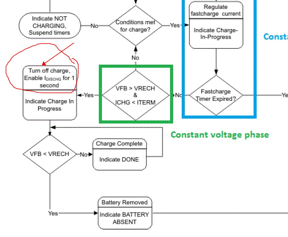

BQ24610: A question about the device operation flow chart?
Part Number: BQ24610
Dear Sir
        when che charge go into the constant voltage mode ,in the next chart why turn off the charge?
        thanks&regards
    That is for battery detection. Please refer to 9.3.23 Battery Detection on the d/s for the details. The IDISCHARGE refers to the 8-mA discharge current.
