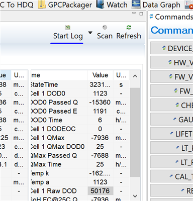

I need to select registers to record log of watch at every time at  lunching  the bqStudio.
If I could store these setting to some file. I could skip these .
Does bqStudio have a function to store the my setting ?

  • Bqstudios has a logging option to save the registers to a log file:

  • Hi Kanao-san,
    The feature to save the log file settings (selection of which values you want to log) does not exist in bqStudio. We can look at maybe adding this type of feature in the future, but unfortunately you will need to make the selections each time you open bqStudio.

    *How to get this data log ?
    There is no “Relative State of Charge” registers in Watch and log file in bqStudio
    How to get log date from it ?
