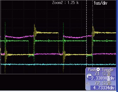

    Sorry to bother you again.Please help me to look at this picture.
    yellow: DPWM0A Vgs (master)
    pink:    DPWM0A Vds (master)
    green: DPWM1A Vgs (SR)
    The two signals DPWM0 A and DPWM1A  should be opened at the same time,and closed at the same time.
    Why DPWM1 looks like open all the period?
    It happened by accident.not always.
    Please help me, and let me know what information you need.or what suggestions you have?
    Thanks a lot
    Best Wish
    Zoe
  • Hi Zoe
    Yes, the green trace doesn't look correct.
    It seems like you are getting some kind of pulse extension.
    It looks like you are in resonant mode (and not PWM mode) when this occurs, can you confirm this? Or does it perhaps occur when transitioning between PWM and resonant mode?
    Is this load dependent? What load level is this issue occurring at?
    Could you send on a "normal" waveform, where the green and yellow are in concert?
    Could you send on your register configuration for the filter you are using and for DPWM0 and DPWM1 please?
