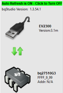

While I was updating flash parameters using the instructions found in the bqfs (which was created by the bqStudio 1.3.54.1), due to a debugging error the process stopped midway. After this incident, I have been trying to communicate with the gauge through EV2300 with no success as it does not respond on address 0xAA nor 0x16. I have also attempted to exit ROM mode and use a srec file to program an image file to the gauge again, but it did not work either.
Is there anything missing me at this point? Attached to this post follows part of the dashboard of the bqStudio.
