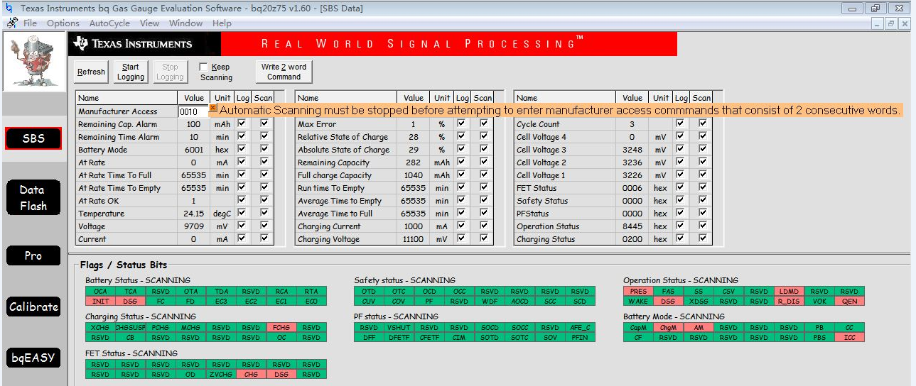

     two questions ask:

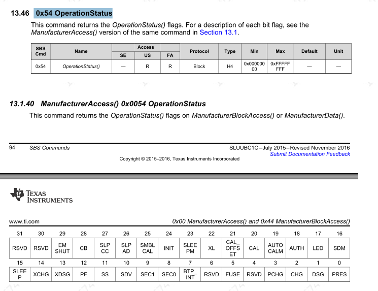

    1. About OperationStatus register ,from the BQ40Z50-r1 Technical Reference,i knwon that,it has two way to access,one is used   0x54 register  ,another way is ManufacturerBlockAccess() or ManufacturerData(),
         These two way can read the same results?

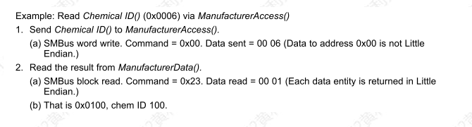

    2.How to read ManufacturerAccess() 0x0054 OperationStatus register? is the same as below? First write command 0x00,data sent 0x0054,then read command 0x23?
    Thanks!
  • Manufacturer Access  enter 0010,but device(bq20z75)can not enter into shutdown mode,why?
    From what I have worked with the BQ40z50-R1, you can get the value of the register using any of those methods, just take into account the the ManufacturerAccess() uses the 0x00 command, then the data sent using Big Endian, and to read the value you send command 0x23. If you wish to read ManufacturerBlockAccess() you use command 0x44 then send the adress you wish to read in little endian (54 00 in your case) and then use command 0x44 again to read. The ManufacturerBlockAccess() will give you the address first and then the value of the register. For example after reading you will receive 54 00 XX XX XX XX where each X is the data in the register.

  • Hi
    Thanks for your answer. I can read OperationStatus register with SBS cmd 0x54,also ManufacturerAccess()0x 0054?
    Do you mean that? Thanks!
  • Hi
    Yes, but in both of those cases you will need to read the ManufacturerData() sending 0x23.
    I hope this helps you.
