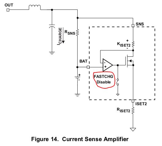

We are using BQ24125 to charge 3 cell Li-ion battery & facing issue in battery charging. Required charging current is 1 Amp, Pre-charge current 0.1Amp.
Input voltage is 15V. Battery current state voltage is 10.8V.
We are following below schematic.
Please clarify below points:

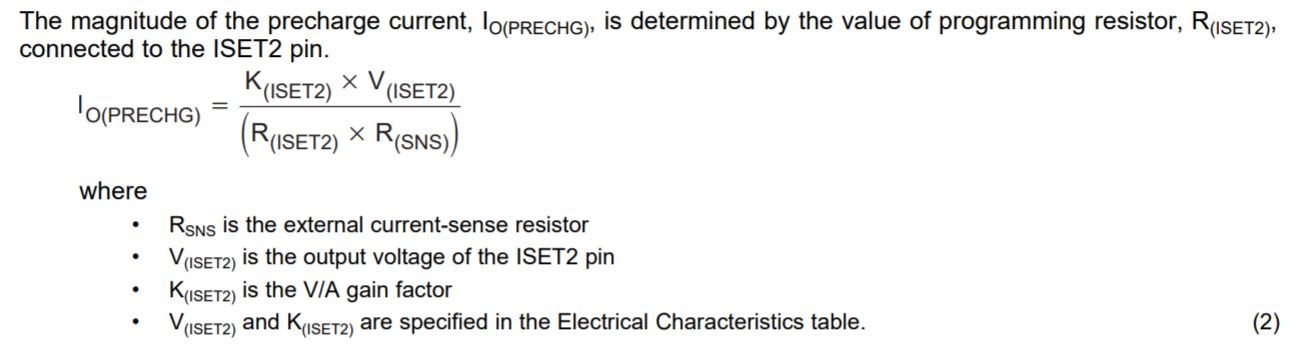

1. ISET2 resistor value (10k) in schematic PMMP5309 & calculation given in datasheet is doubtful. It should be 1k to set a pre-charge current of 100mA.
2. We have clearly observed battery detection voltage waveform as per Figure 12 in datasheet but current does not rises. Battery current remains ~2mA. What could be the issue?
Please note that TS pin voltage is 1.58. TTC pin is grounded.

  • Vinod,
    1.Referring to the equation below, VISET2=100mV, KISET2=1000V/A, RSNS=0.1OHM, RISET2=10KOHM, so IOPRECHG=0.1A.
    2. The output signal switches between VOREG and GND until a battery is inserted. Only when the battery is detected, the output current increases.

  • Hi Ning,
    1.RSET2 is for fastcharge  OR pre-charge. Please see below figure. Also please note that with 10k resistor we observe 1V & with 1k resistor we observe 0.1V at ISET2 pin.
    2. Our battery is detected but still current is not rising. What could be the issue? It seems that it is in some fault state.

  • Vinod,
    1.RSET2 is to set pre-charge current only. The device can’t be controlled by both fast charge loop and pre-charge loop at the same time. The fast charge loop will be disabled when pre-charge loop is in control. Please refer to the functional block diagram for the details.
    2.Do you have gauge or protection IC in between the charger and the battery pack?
