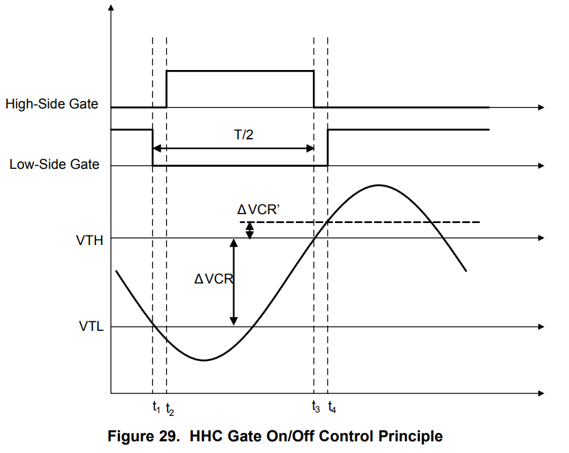

    UCC25630x monitors the amplitude of the resonant current via its ISNS pin. Core saturation can be avoided by proper selection of the ISNS parameters to trigger OCP before the core saturation point of the transformer.
    Switching frequency is dictated by the FB signal and the VCR pin waveform (VCR is the sampled resonant capacitor voltage). The VCR pin has a 3V DC offset. The amplitude of the feedback signal sets two two switching thresholds symmetric around 3V on VCR.
    VTH controls the gate turn off of the high side FET. VTL controls the turn off of the low side FET. The turn on of both high side and low side FETs are controlled by an adaptive deadtime circuit. As the FB signal increases in amplitude, VTH and VTL move farther away from 3V. This decreases the switching frequency.
    If you can share your design spec and transformer details, I can help you select the appropriate IC parameters to satisfy the requirements given to you by your transformer manufacturer.
    Ben Lough

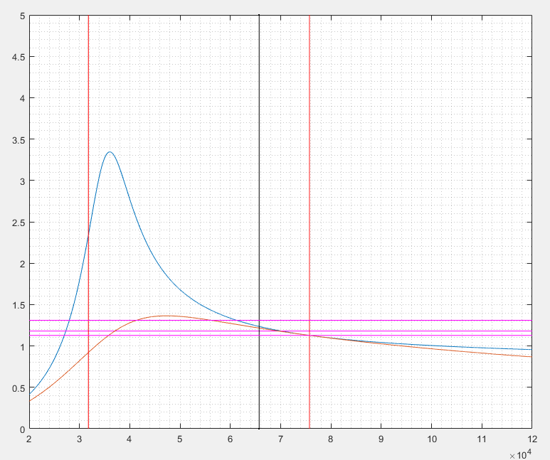

    To clarify my problem why I am thinking of lower frequency limitation, I calculated the transfer function of the resonant circuit for medium and high load (by matlab). Vertical lines are min. and max. gain requirements, right vertical line is f0 and the black line in the middle is the recommended minimum working frequency of the transformer.
    While there is no problem for medium loads, high load condition has a special problem. High gain requirements could be fulfilled, when working frequency would be regulated to about 55kHz. This is still above ZCS but very much below recommdended low frequency limit of the transformer.
    Unfortunately transformer power capabilites decrease a lot with lower frequencies. Therefore, there might be an additional  big voltage loss due to the transformer and the controll mechanism would decreas frequency even more. There migh be a lot negative effects because many "bad things" come together.
    If I could limit the lower working frequency directly - ok, I will have a voltage drop because of insufficient gain of about 10 to 20%. But that's all.
    Thank you for offering help. I would really appreciate that.
