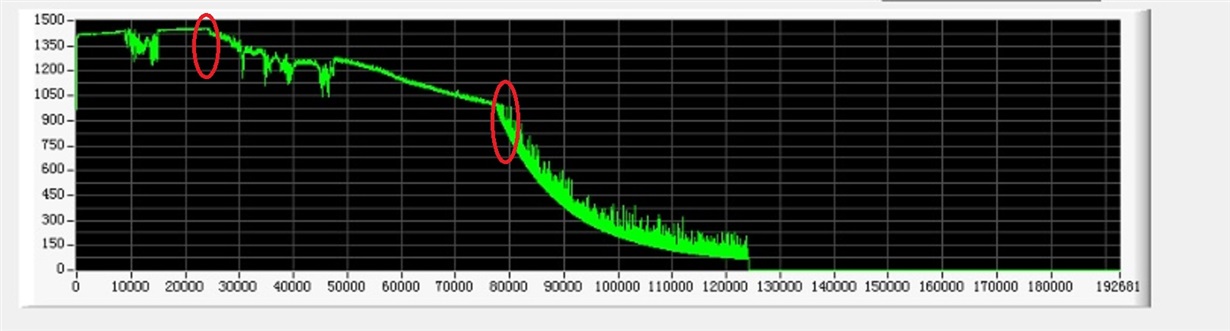

BQ24157: charge current decreases prematurely during current regulation phase
Part Number: BQ24157
Dear all,
register 0x04(B4~B6) 0x06 or 0x07, charge current decreases prematurely, please refer to the attached.
register 0x04(B4~B6) 0x05 or lower, charge current decreases normally until entering CV .
what's the reason for the difference? thanks
