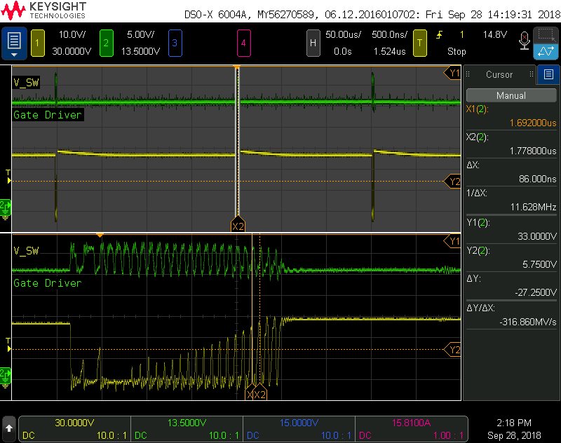

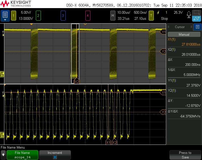

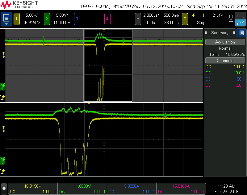

Shown above is a 4.2A SLA charger circuit with external 4.2A current limit circuit removed because the issue happens with that circuit removed. The circuit performs well, meeting its desired output voltage, current, and dominant switching frequency. The problem is that during the 'off time' of each switching cycle the controller is oscillating at ~5MHz instead of turning the FET off. The gate driver inside the LM3489 is somewhat weak and during this time the FET goes linear and dissipates so much heat that it exceeds its junction rating. I have not found any way to stop this from oscillating, below is a list of some of the changes I've tried (one at a time):

Despite all of those attempted changes, the part still oscillates during the off-cycles. I am out of things to try. How can I get this to stop oscillating?
  • I forgot to mention, the 50pF capacitor in the spice model is a reliable way to simulate the oscillation and is not part of the design. Unfortunately, changes to the spice model that fix the oscillation do not work in the real world.

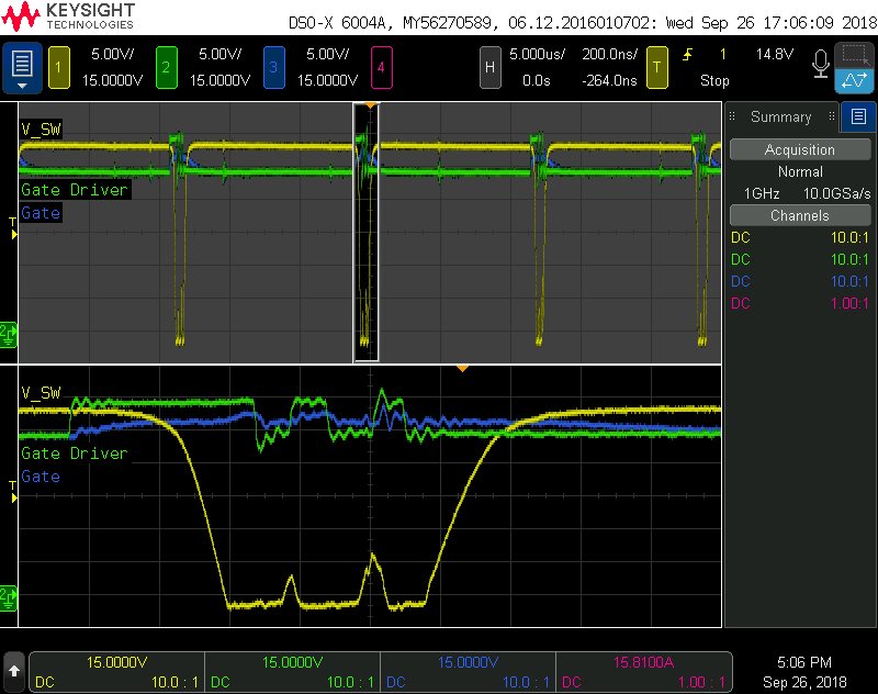

  • That didn't improve the problem, it is actually just holding the FET linear through most of the off cycle. What's notable is that shortly after the switching node reaches ground, when no part of the system is changing states, the FET is getting turned on. Shown below with 250ohms:
  • Yes; that is why I was thinking that the FET/drive combination is oscillating. Could you try a FET with different capacitance ?

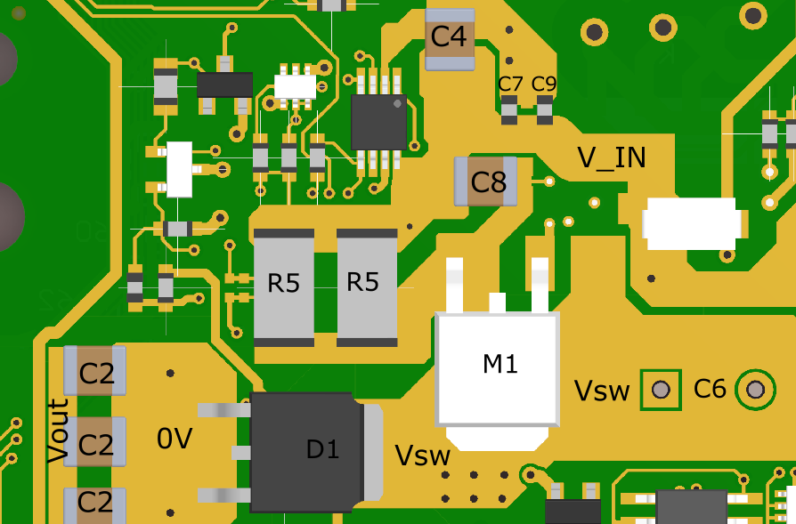

    It looks like you have good input bypassing. Are C7, C4, and C9 close to the VIN and GND pins??
    Also is the FET gate close to the IC ??

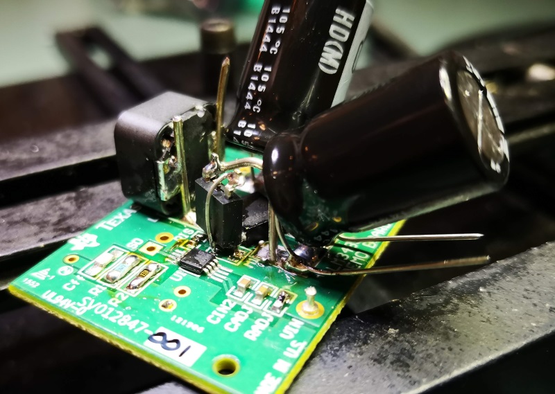

  • As I said in my first post, I have already tried a FET with a much larger Qg and I also put a capacitor in parallel with the gate to drive the capacitance even higher. I also said in my first post that I already modified the EVM with my own components and it still oscillated, I even put a picture of that board showing my best effort at fitting my larger components on such a small board.

    You could try to get C7 and C9 closer to the VIN and GND. And maybe get the gate of M1 closer to the IC.
  • The FET I started with was the FDD5614P (Qg=15nC @ 10V), the best I could find was the STD10P6F6 with Qg=6.4 @ 10V before the Rdson would get too high. This improved the oscillation but did not make it stop.
    I can't move M1 any closer without re-laying out the board, and at this point if I'm going to change the layout without knowing that it fixes the issue I'm going to change to a constant frequency converter like the LTC3824 and avoid the issue altogether.
    STD10PF6F6 (2.5x less Qg) with C7 and C9 moved directly onto the IC pins:
    And I also added another 4.7uF ceramic capacitor across the pins, still didn't address the issue:

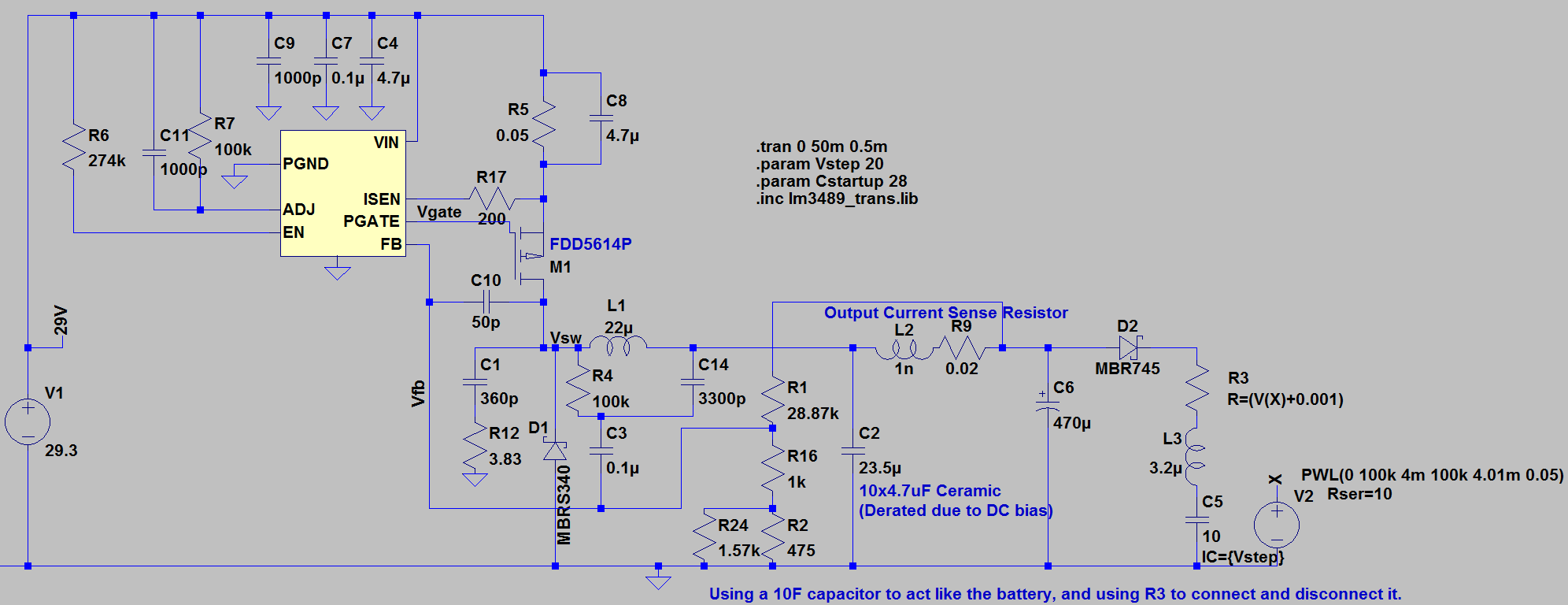

  • Daniel,
    Your schematic has R5 for current sensing but the datasheet recommends connecting the ISEN resistor (R17) directly to the drain of the PFET. Have you tried connecting R17 to Vsw as opposed to the source of the PFET?

  • Hi Sam,
    Thanks for looking at this. I tried changing R17 to 0ohm and it did not stop the oscillation. I have not tried using Rds_on current sensing because I am following the recommended setup in Figure 23 for using a designated resistor (although you were right and R17 was only for Rds_on sensing).
    One observation I've made: If I change R7 to be much lower than required and I use a resistive load on the output such that the converter still makes the desired output voltage and current the oscillation is gone. In other words the fixed overcurrent one-shot off-time is not susceptible to this oscillation issue.

    I just noticed C10. That will pull FB low every time SW goes low which may trick the part to turning back on immediately (after Ton_min which is 100ns which is what we're seeing in your waveform). Try removing C10 and testing again.

    Can you also share the schematic of the board as opposed to the sim file. I'd like to know what other than C10 is not the same.

    Here is the schematic, I have also attached it as a .pdf since image compression seems to be trashing it.
