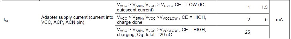

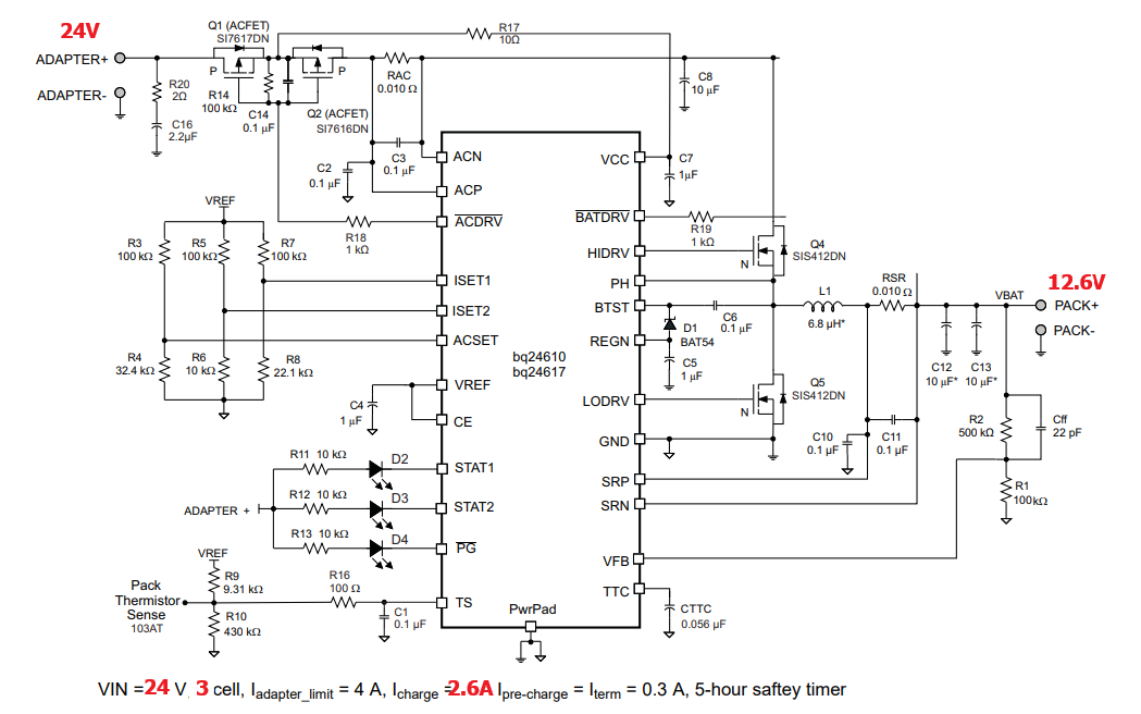

I'm currently developing with BQ24610.
I have problem to calculate the thermal temperature for this IC. How to calculate ?
