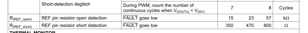

        I Read the datasheet about the Rref detection. The open and short protection valve as follows.
Does it  means the minimum current should above 1.222*100/15K=8.2A.  any suggestion about the minimum current?
