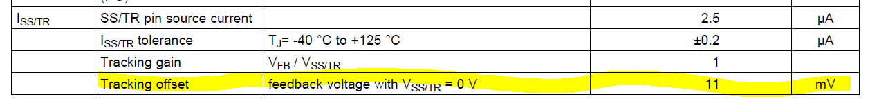

I have a question about TPS62136 SR/TRK function.
Now I’m trying forced discharge by changing SS/TR from high to low(=0V).
But VOUT doesn’t go to 0V and continue to output about 0.3V even if SS/TR=0V.
And it looks to be regulated to 0.3V.
I think this behavior is defined as ISS/TR Tracking offset like the below table in the datasheet.
My question is that is there any way to discharge completely, meaning VOUT=0V, by SS/TRK function?
Also could you tell me where does this offset come from?
