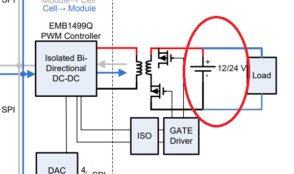

  • Hi Mcupwr,
    Just to clarify before continuing, do you have a 12V battery connected to the other side of the transformer as shown in this image:
    Thanks!
    Vince
  • Hi Vince,
    Yes, 12.5V battery is on J1 connector, T1 have 12V on pins 1 and 3, Q4 drain is on 12V (armed) without PWM on gate.
    On pin 11 (U3) is 4.5V, which holds Q3 gate on high and on the low pin 8 (EN, U2).
    Tnx
