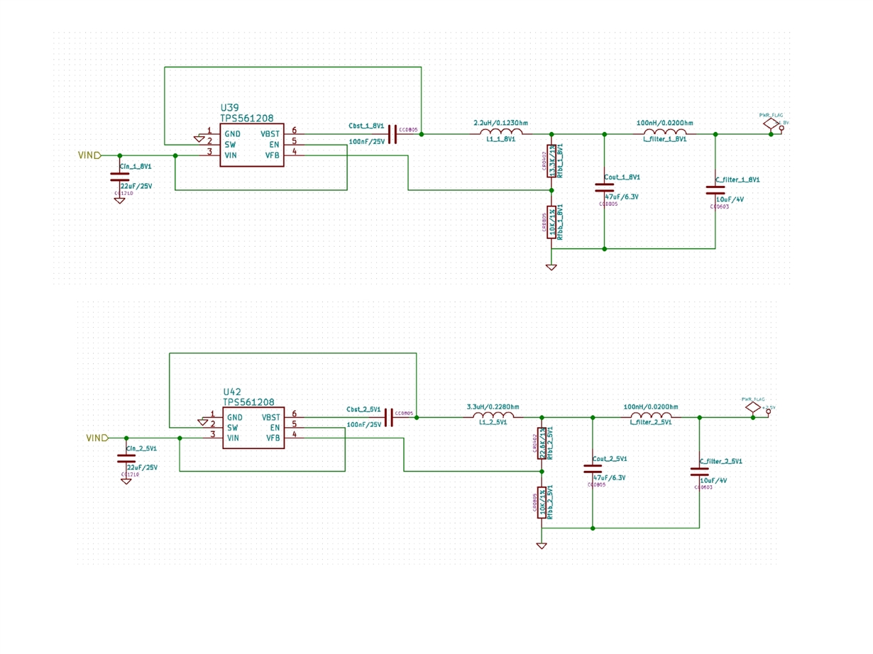

I just power a new custom board, the two TPS561208 on it created a shortcut.
We unsolder them.
The first one have GND and SW which are internally solder together.
The second one have GND ,SW and VIN which are internally solder together.
We have other component powered by the same input which are working fine :
 TPS53513 and TPS563219DDF
We are wondering what could cause such effect.
In the attach schematic Vin = 12V.
