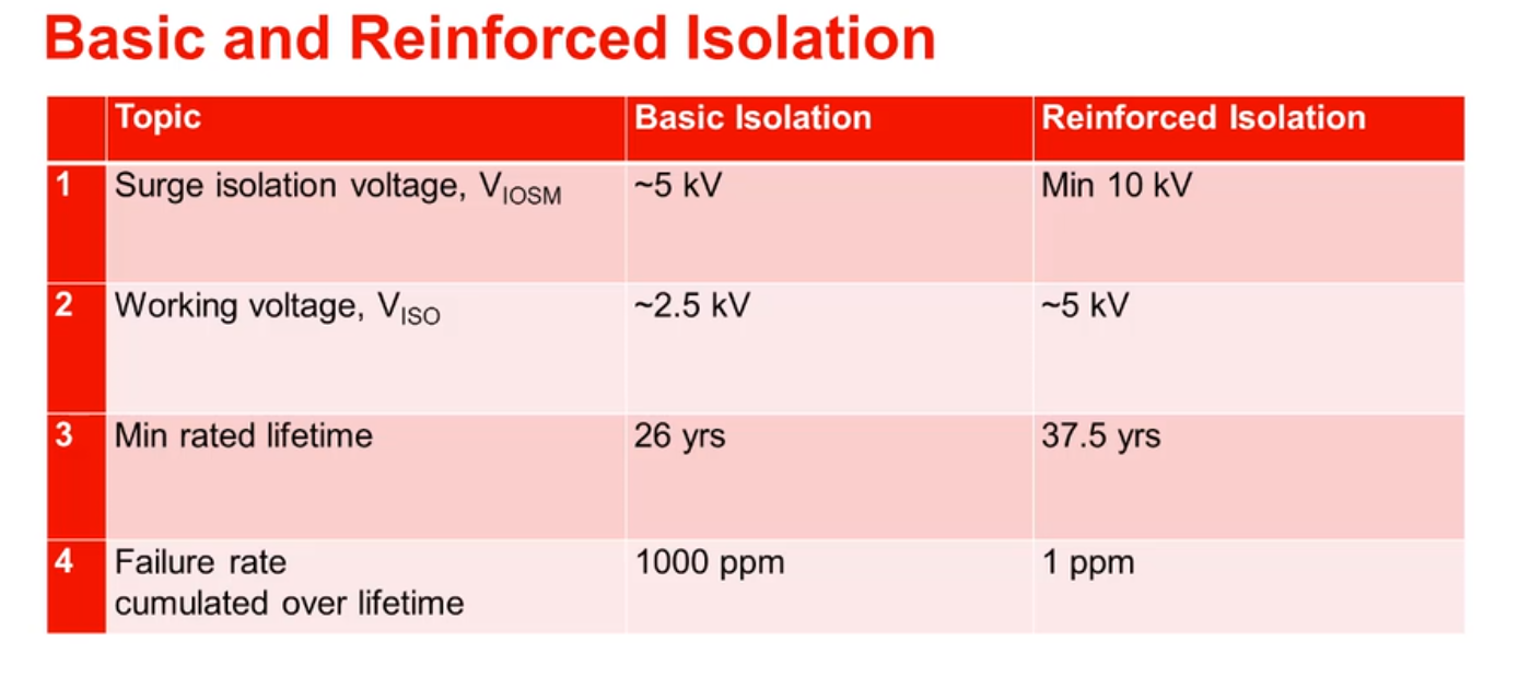

In isolation training below, it's said that Visom should be at least 10kV for a device to be classified as reinforced isolation, is it true?
https://training.ti.com/isolation-parameters-overview?cu=1135015
