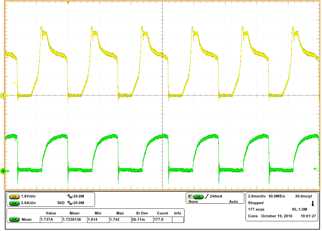

    If my opinion is correct, is there data on how the current limit value from 1.6 V to 1.0 V changes? --> In fact, when the Io is high and the Vo drop to below 1.6V, the output is a pulsed current instead of the continuous current. when Vo drops below 1V, the Io is a constant around 100mA current.  Please check the attached waveform.
