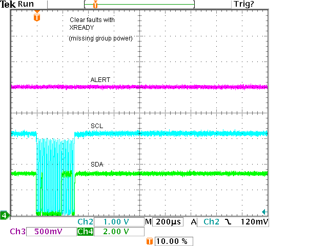

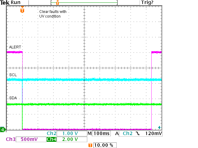

  • Hi Vikas,
    It depends on the fault.
    A UV fault for example is determined over time.  You can clear a UV fault and it will be checked again, and if still UV the status and ALERT will set again.
    Clearing a fault while the fault is still present will not change ALERT.  An example is attempting to clear XREADY when power is missing to the upper group.
