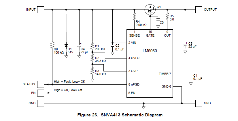

Please help to review the schematic.VIN IS 12V,the current is 60A.thanks a lot.
Hi User,
For hot-swap function, I recommend to use LM5069 which provides accurate overcurrent protection and FET SOA protection.
The overcurrent protection with LM5060 depends a lot on FET Rdson which varies with operating/board temperature.
Have a look at LM5069. If you decide to go with LM5069, Please close this thread. And send me filled up design calculator www.ti.com/.../toolssoftware in a new thread for review.
