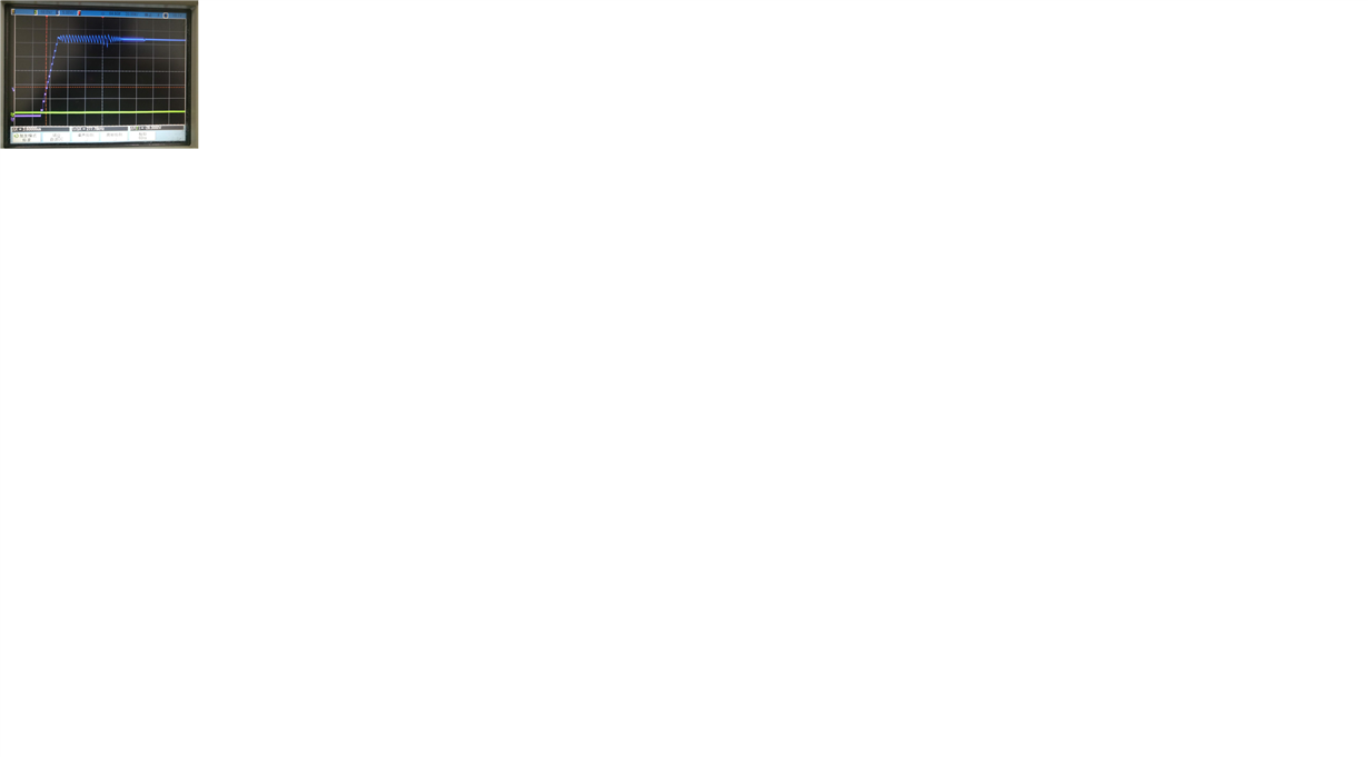

The secondary rectifier adopts soft start. The no-load start-up waveform is shown in the figure below. What problem can cause this startup waveform?
What is the exact part number you are using? Is it UCD3138 or UCD3138A?
This feature is not enabled as default in the UCD3138HSFBEVM-029
In UCD3138A the hardware increases the SR pulse in the oposite direction, therefore the Sync-FET soft On needs to be handeled by firmware (Firmware implementation does not use the hardware ramp mechanism).
If the device you are using is UCD3138, then you may want to tune the rate of SR soft on and look at the SR pulse growing properly, using an Oscilloscope before you look at the end result.
