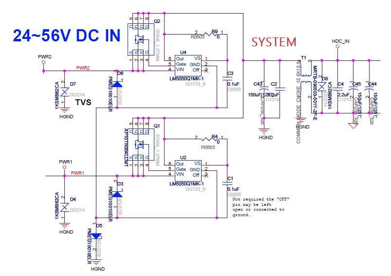

LM5050-1 Leakage question :
follow below pic circuit, PWR2 provide DC 24V and PWR1 is open, then U4 LM5050-1 turn on MOSFET and offer DC24V for Systme ,But we detect DC1.2V in PWR1 net , please help Explanation it, thanks !

Hello James,
Please refer to the attached test report for the leakage path.
7360.PMP20096_LIQ_REVA_TEST_BJT.pdf
