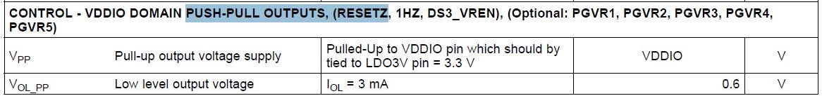

Customer inquired that he could not get a low level out for RESETZ in low-out logic state.
The RESETZ pin is defined as a push-pull output in the datasheet.
He got a low signal level when pulling up with a resistor, such as open drain.
What kinds of problems are considered?
