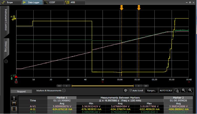

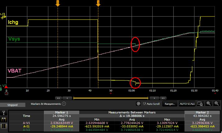

We use battery simulator to emulate the battery to do the charging test. We found the charging current will have slight change during the VBAT=VSYS. Some change is slight and some is large, you can see the picure that we show below. Does it be normal if the current is still inside the tolerance defined in the datasheet?
sample 1
sample 2
