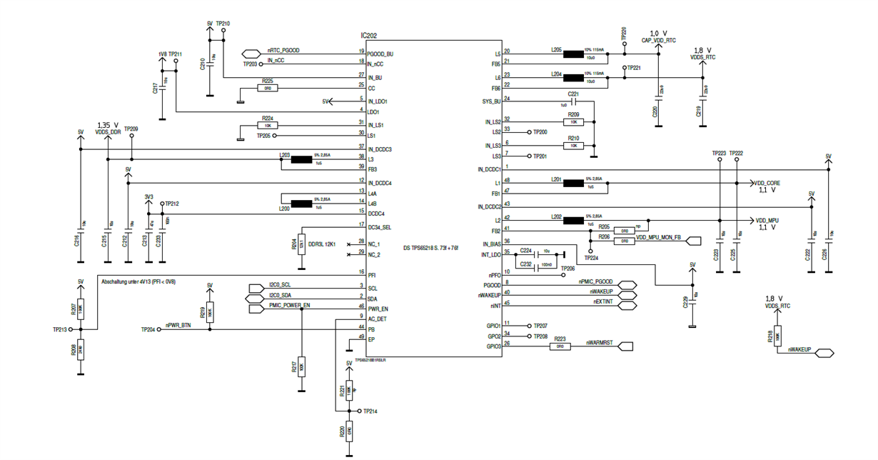

  • Hi Brian,
    my schematic is based on the suggestion in the data sheet of TPS65218B1:
     I checked the signals PGOOD and PGOOD_BU, but the behavior of the signals seems to be normal. There is only the drop in the 500ms break. The suggestion of change STRICT=1b to 0b in volatile memory I didn't try until now. An additional capacitor of 47µ on DCDC4 didn't help.
    What is with the signals AC_DET and PWR_EN in my schematic, is the wiring OK? PWR_EN goes to PMIC_POWER_EN of the Sitara.
    Kai
  • Kai,
    As long as R221 is not populated, the AC_DET is okay. Section 5.3.1.16 AC_DET Input (AC_DET) in the TPS65218D0 datasheet recommends AC_DET = GND for non-portable applications.
    PWR_EN is controlled by the processor PMIC_POWR_EN signal, so this should not be an issue.
    Please measure PWR_EN and PB (push-button) input with a scope to make sure these signals are not causing the problem. In addition, you might want to look at GPIO3 to make sure this signal did not cause a warm reset on DCDC1 or DCDC2.
    Also, it appears you are not using any load switches LS1-3. It could be an issue that you are not using Load switch 1 and the input is grounded, as LS1 is normally powered from DCDC3 and is used to enable/disable DDR power.

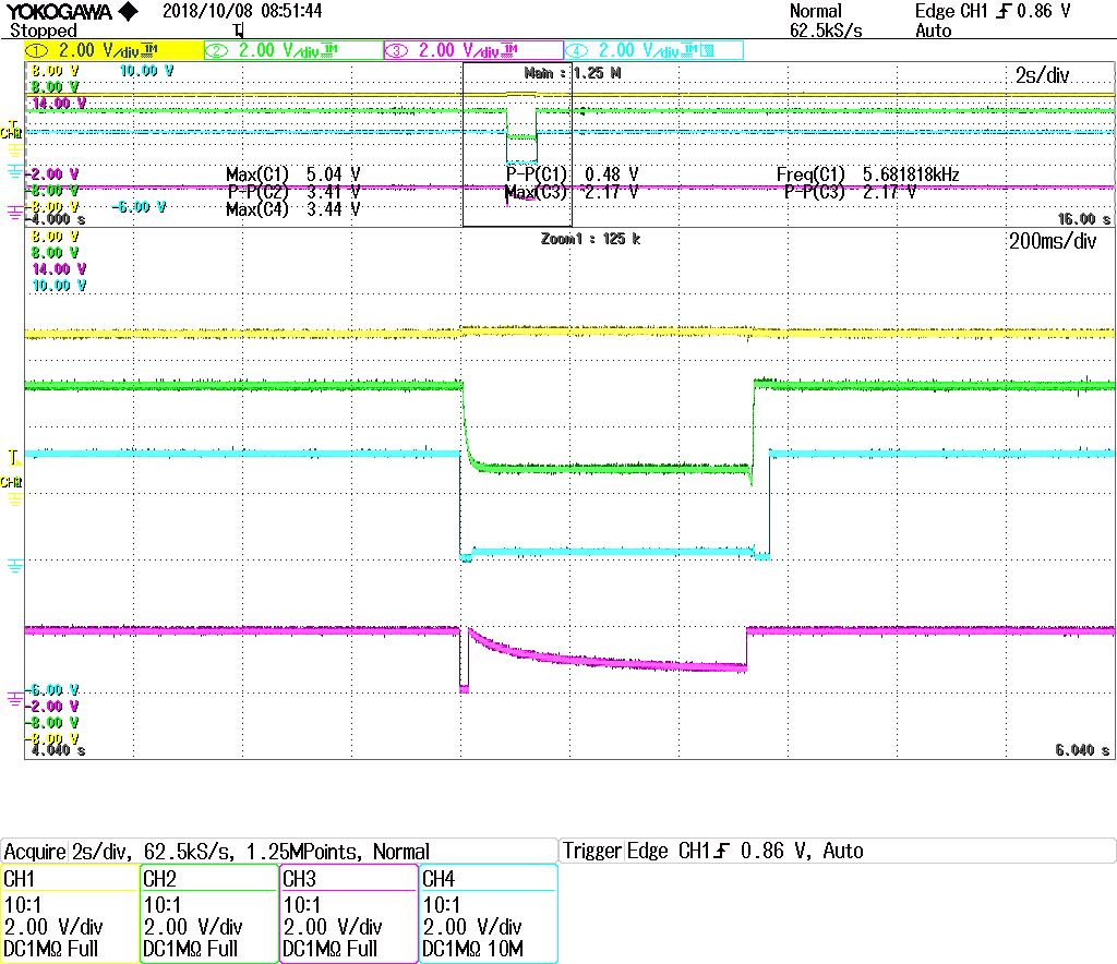

  • Brian,
    here is the scope result (yellow: PB, green: 3V3 (DCDC4), blue: GPIO3, pink: PWR_EN). With R221 populated (AC_DET=High) and R220 not populated I get the same behavior as with TPS65218B0, please see the second scope result. This would be OK for my application. In Section 5.3.1.16 AC_DET Input (AC_DET) is described as follow:
     "In a non-portable system, the AC_DET pin may be shorted to ground and the IC powers up whenever system power is applied to the chip." --> So the IC would never goes in the OFF-state. A falling edge signal on AC_DET seems not to be necessary with the new revision of TPS65218.
    Kai
  • Kai,
    Thank you for taking the extra step to debug and show me your results!
    As long as you are OK with using a Push-Button press (PB toggle hi-lo-hi) to power-on from the OFF state then this seems like the correct method for you and your system.
