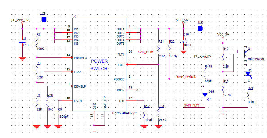

We are using TPS25940AQR for circuit protection.

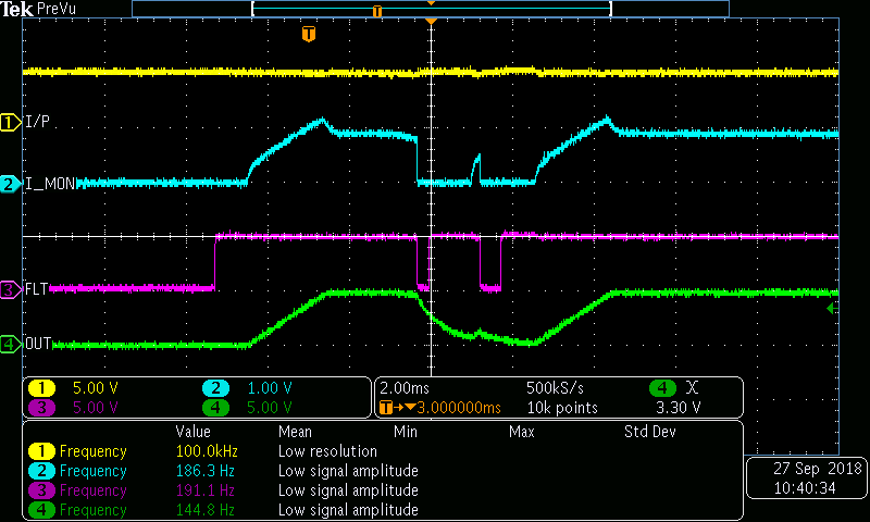

At power ON, we are getting voltage dip as per the below image.
We had verified EN/UVL, OVP as per the graph mentioned in the datasheet. EN/UVL, OVP is exactly the same as mentioned in datasheet.
Also, we had isolated all the output components from the board(output of Efuse) and an external resistive load of 1A is connected.
 The below waveform  explains the issue
Ch1: FLT# pin voltage with pull up 5V
Ch2: Output 5V supply.
The schematic file is provided.
