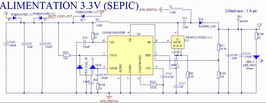

I am finalizing my design of a SEPIC supply based on LM3481, and I would like that some TI engineer validate my schematic, please.
Vin = 23.5 to 28V
VUSB = 5V
BATT_LIION_OUT = 3.2 to 4.2V
Iout = 220 mA / 1 A peak
T° range : 5°C to 70°C

    Thank you for considering the LM3481 in your design. The schematic basically looks okay.
    (1) Just wondering why you use a TVS on UVLP pin. Shouldn't it be a Zener other than the TVS? Anyway, you may increase R58 to reduce the power loss in the voltage clamp device when VIn=28V.
    (2) BATT_LIION_OUT may not work, because the LM3481 requires a min input voltage of 2.97V. The forward voltage drop of D1 will reduce your 3.2V to below 2.97V.

  • Hello Youhao,
    Thank you for your reply.
    1) I have put a TVS instead of a zener because I already had it in my BOM, whereas I hadn't any Zener. I will put a Zener and increase  the value of R58 as you suggest.
    2) If the systems stops when BATT_LIION_OUT reaches 3.3V it is not so important, as it is a secondary supply, used only in emergency cases.
