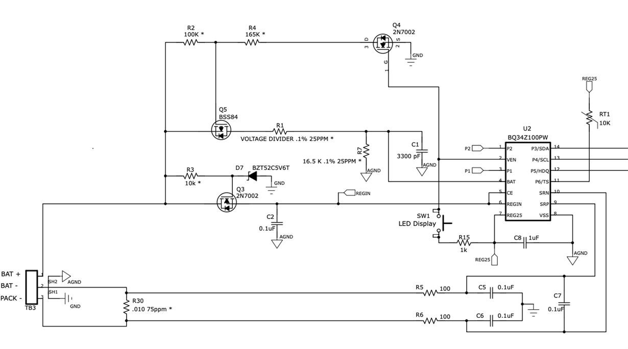

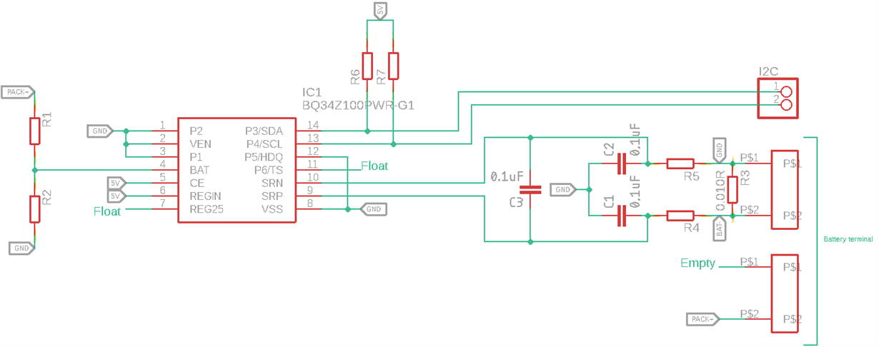

I don't have evaluation module of Fuel gauge and EV2400 for communicating gauge to BQ studio. I have made following circuit for operation. I am connecting Gauge via Arduino. Can you tell me exact calibration process for gauge through Arduino or any other microcontroller.

    With respect to the schematic above, please not that the datasheet lists REGIN as a max of 4.5 V and also requires a 0.1 uF cap tied to ground near the pin.  Power supply recommendations are listed in section 9 of the datasheet.
    Also, with respect to the current sense portion of the schematic, please refer to the schematic as shown below:
