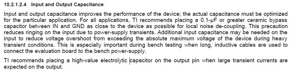

  • Hi, Bob,
    Are you try to define output cap for TPS2553 application? See my input below for your question:
    1. Actually, the current you calculated is injected more in input cap of TPS2553 and output cap of DC-DC, the ripple for this is the current * ESR. To use TPS2553, you don't need to consider the ripple at soft start. You just need to optimize DC-DC operating ripple(switching ripple and output cap charge and discharge ripple). If there's low frequency ripple in TPS2553 Vin from 20kHz to 270kHz, fault deglitch time will be prolong.
    2. For ripple, it will not influence deglitch time. Below is TI suggestion for input and output cap.
    Feel free to ask any questions.
    Bao

  • Hi, Bob,
    Sorry for confusion.
    Vin ripple will influence the deglitch time, but vout ripple will not influence the deglitch time. You do need to optimize the DC-DC ripple(for Vin of TPS2553) incase influence deglitch time.
    Bao
