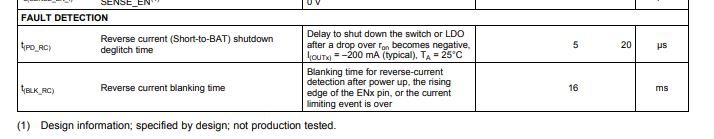

  • Hi Ryan
    thanks for your response and I see that the discussion is going in the right direction. Let´s have a more complex view on the failure modes of the device.
    1) Output Short2Bat Condition at the Output of the TPS7B770x:
    As you already described, the device will protect the input from a S2B condition. I suppose the protection circuit will have a certain delay. What happens with the input when a S2B condition happens within the delay-time (means the protection switch is not yet turned off) ? What is the delay time of the protection circuit ?
    2) Output Short to GND
    Similar to 1) what happens when a hard short to GND happens  at the output but the protection circuit is not yet ready to limit the current ? What is the delay time of the OC protection circuit ?
    3) Reverse Current
    Similar to 1) what happens when a reverse current happens but the switch is not turned off because of the delay time ? What is the max. reverse current that might occur and how does it impact the imput of the device ? What is the delay time of this protection circuit ?

  • Hi Matthias,
    The Short-to-BAT detection time is specified in the Switching Characteristics table as a typical of 5 us.  During this glitch time, it is possible for the LDO to be on.  As the title of this fault implies, before the protection circuitry engages, the input and output rails are shorted together.
    If the output is shorted to GND, the current limit for the LDO will limit the current.  As nothing in the real world is instantaneous, there will be a short delay before current limit engages.  This is also what allows inrush current to occur during startup.  This delay is not characterized; however, it will be similar to the short-to-BAT deglitch time.  Since the LDO output current is equal to the LDO input current minus Ignd, the increased output current will come from the upstream power supply.  How the power supply reacts to this current will be dependent on its current limit.  If the upstream supply cannot source the current, the input voltage will droop.
    If the output voltage exceeds the input voltage of the LDO, reverse current is possible.  The blanking time for reverse current detection is typically 16 ms.  During this blanking time, reverse current can flow in the OUT pin and out the IN pin.  This current will flow into any capacitors on the IN rail and raise the input voltage.  How your upstream power supply will react to this will again be dependent on the upstream power supply.
    All fault conditions with the LDO should exhibit as either additional current flowing into the IN pin of the LDO which would lower the input voltage rail voltage if the upstream power supply cannot source the additional current or it will exhibit as current flowing out of the IN pin as reverse current which would increase the input voltage rail voltage.
