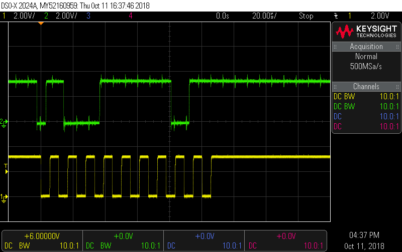

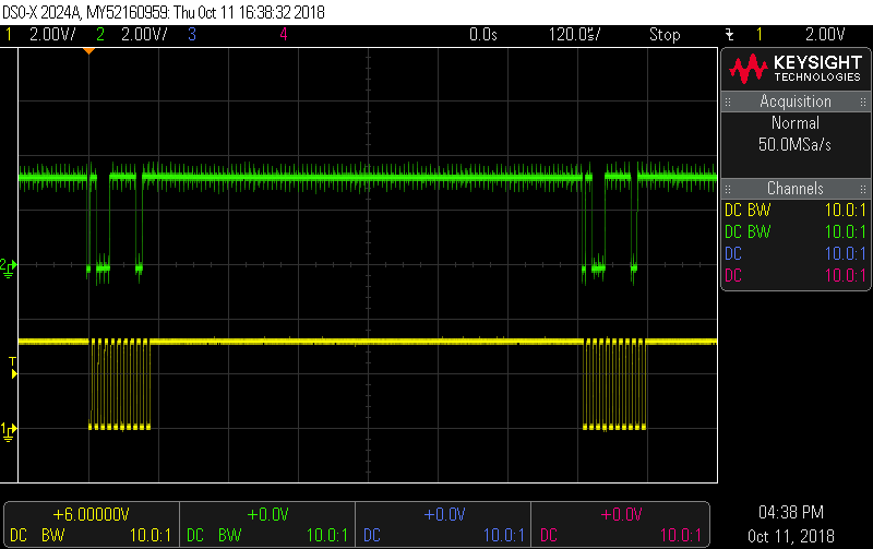

  • The device address has definitely not inadvertently been changed. The only transactions being sent are page set commands and block reads. Most devices have the address set by resistors. I was able to gain some scope captures. It has been verified that the bus is not held low by any device when the UCD is unresponsive. Attached are two captures of the device NACKing. Forcing SCL low by the master for greater than 35ms was not successful in recovering the device. The FPGA master that is communicating with device does not transmit the page set command byte following the address transmission.
    Besides a hard reset of the UCD device, do you have any other suggestions for recovery?
  • you can see from the waveform, the NACK is happend on the address. it seems that the address is wrong or it has been changed.
