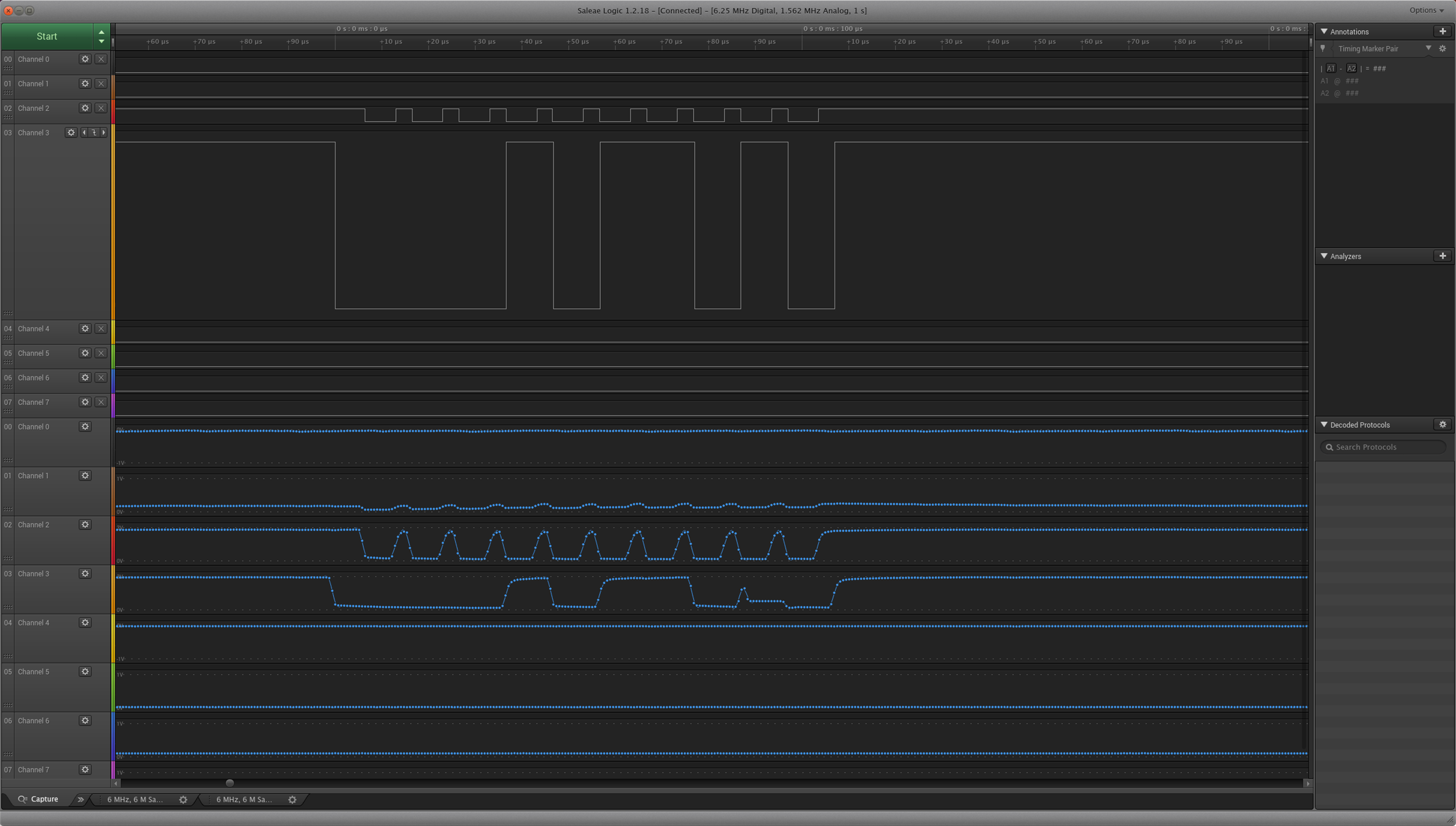

I use Linux to communicate with bq40z50-R2 battery. However, it's not responding to my i2c commands. I am able to talk to it fine using bq studio though. I used default slave address 0x0B.
Here is the output of i2cdetect command and the scope when I do a i2cget from address 0x0B.

  • Hi Huize,
    The bq40z50-R2 has SMBus communication which is a little different from I2C. Make sure to take a look at this SMBus app note below. On page 10, it has a list of common issues that might help you identify your problem.
    www.ti.com/.../slua475.pdf
    One thing that is very important for the bq40z50-R2 is to make sure your pull-up resistor values are sized properly. If you are using lower than the recommended values, the device might not be able to properly drive against the current load.
    Matt
